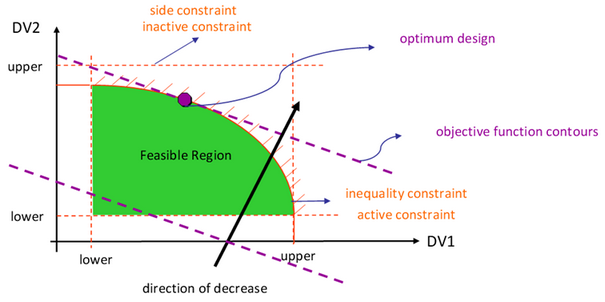

Some of the results that would be reported after an optimization run include but not
limited to:
- Optimum Design
- The point or design that minimized (maximized) the objective function
and at the same time satisfy all the constraints.
- Violated Constraint
- Constraint that is not satisfied.
- Active Constraint
- Constraint that is satisfied exactly; equality constraints are active
for feasible designs.
- Inactive Constraint
- Constraint that satisfied but not on the bound.
- Feasible Design
- A point or a design that satisfies all the constraints.
- Infeasible Design
- A design that violates one or more constraints.
Figure 1. Design Space Definitions
