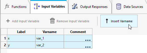

- Click the Input Variables tab.
- In the work area, select the input variables x and y.
Click Insert Varname.
The input variables appear in the expression as ros_eval(var_1, var_2).Figure 3.

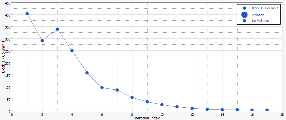

- Optional:
Click the Iteration Plot tab to monitor the progress of
the optimization.
The iteration history shows a significant reduction in the objective value. The Rosenbrock function has a global minimum that is difficult for any optimizer to find due to its flatness in the area of the true optimum, and ARSM has not found the theoretical solution at (x,y)=(1,1).
Figure 5.
