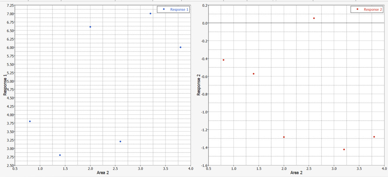

Evaluate tasks.
- Go to the step.
View a plot which illustrates the dependency between Area 2 and Response 1 and
Response 2.

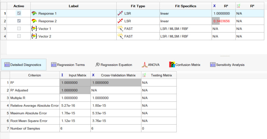

Define specifications.
- Click the Fit Specifications tab.
- In the work area, Fit Type column, select Least Squares Regression (LSR) for both output responses.
- Click Apply.

Evaluate tasks.
- Go to the step.
- Click Evaluate Tasks.
Post process results.
Go back to the Specifications step and try different
methods until you find an acceptable fitting for both output responses.
With first order least squares, you have a Fit which explains most of the data’s variance, but it still has a relatively high prediction error.
