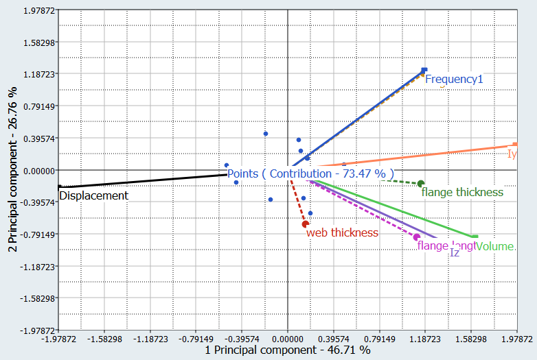

Click the Ordination tab.
The biplot is interpreted by looking at the relationship between the lines that each represent one input variable or output response. The Displacement and Iy output responses show a strong negative correlation because they are aligned, but pointing in opposite directions. The displacement and Iy are also not at all correlated to the input variable web thickness, indicated by the orthogonality. Similar strong positive correlations are seen between the frequency and height or the volume, Iz, and flange length.
Figure 5.
