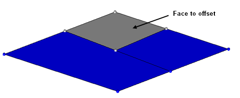

- offset_dist
- Specifies the offset distance. The sign defines the direction of the offset. A positive value corresponds to the offset in the direction of the faces normal. A negative value corresponds to the offset in the direction opposite to the direction of the normal.

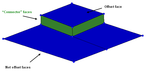

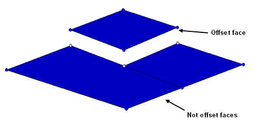

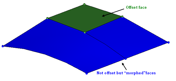

- continuity_mode
- Specifies the type of continuity between offset faces and faces in the same shell that
are not offset or offset a different distance.

- num_connector_faces
- This member returns the number of connector faces that were created to preserve continuity between offset faces and faces that were not offset or offset a different distance.
- connector_faces
- Returns the pointer to the array of connector faces that were created to preserve continuity between offset faces and faces that were not offset or offset to different distance. The number of entries in the array is num_connector_faces.

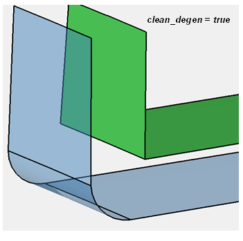

- clean_degen
- The flag that specifies whether additional check and cleanup should be done for possible degeneracies of the faces resulting from the offset to large distances.
Note that setting this to true can significantly slow down overall performance of the offset function. It is, therefore, recommended to set this option to false for large models with relatively small offset distance values.
