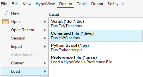

You can run HWC command files in the following ways:
File Menu Support
- From the File menu, select to execute the HWC command.
