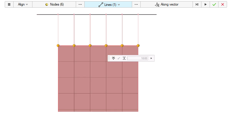

Click
- Project source nodes on to a target line

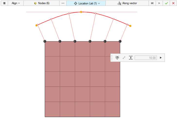

- Project nodes on to a smooth line (smooth lines can be defined using the
location entity)

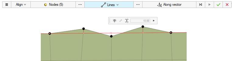

Figure 3.

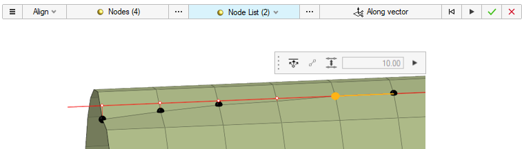

- Align nodes between start and end nodes
Figure 4.

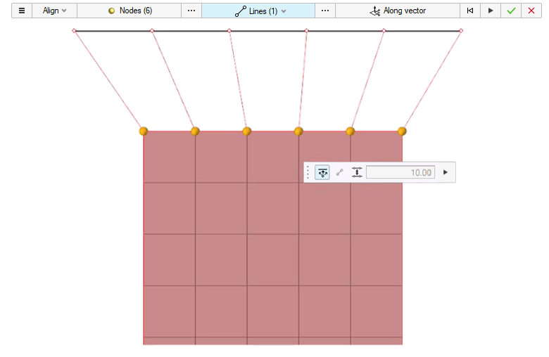

- Align nodes with respect to reference nodes
Figure 5.

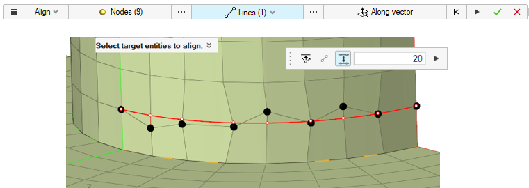

- Align + Remap
Figure 6.
