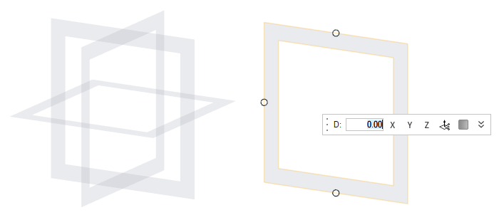

Pick an initial orientation from the suggested global X, Y, or Z frames.
Resetting the plane selector shows these initial suggestions again.

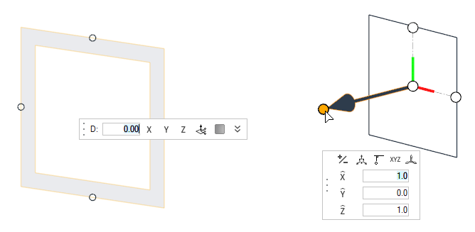

Click and drag the frame area to reposition it along its normal direction using
snaps or a distance value.
Use the options in the microdialog to help position the plane or change its options:
- D
- Distance offset value.
- X, Y, Z
- Align the plane to the corresponding global axis.
- Invoke the Vector tool (see below) for advanced plane editing.
- Toggle the plane representation between a frame (default) and a filled rectangle.
- Center
- Plane center coordinates.

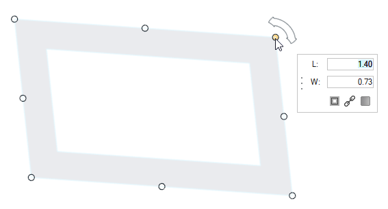

Resizable (finite) planes have handles on all sides and corners and can be
dragged to resize in any direction. They also have in-plane rotators that appear
near the corner handles.
Figure 3.
Tip: While resizing, hold Ctrl to resize from the center, and Shift to lock the aspect ratio.Use the options in the microdialog to help resize a finite plane:
- L, W
- Plane dimensions.
- Toggle to resize from the center (Ctrl).
- Toggle to lock aspect ratio (Shift).

Click and drag to move the base handle – the point in space where the
plane/vector is located. Then, drag the handle at the tip of the arrow to define
a vector, or drag two handles on the edges of the plane to define a plane.

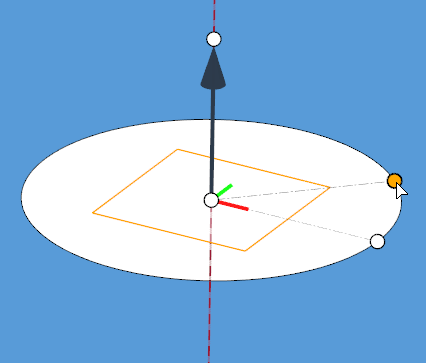

Figure 4. . Example defining a vector using the plane handles. A spin axis is defined normal to 3 locations on a circle.

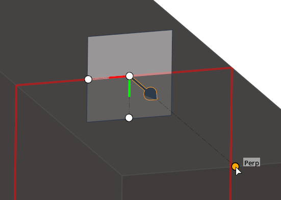

Figure 5. . Example defining a plane using the vector handles. A split plane is defined normal to a point and its perpendicular projection to an edge.
