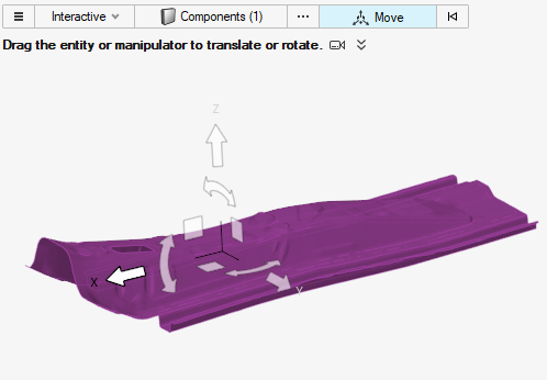

- Move Tool
- Selection and manipulation are now separate actions with the addition of a new move button.

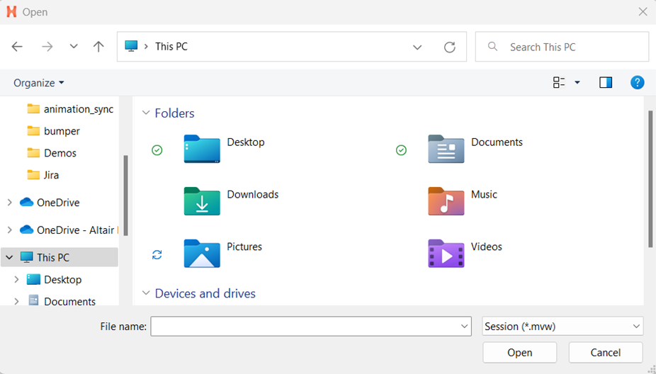

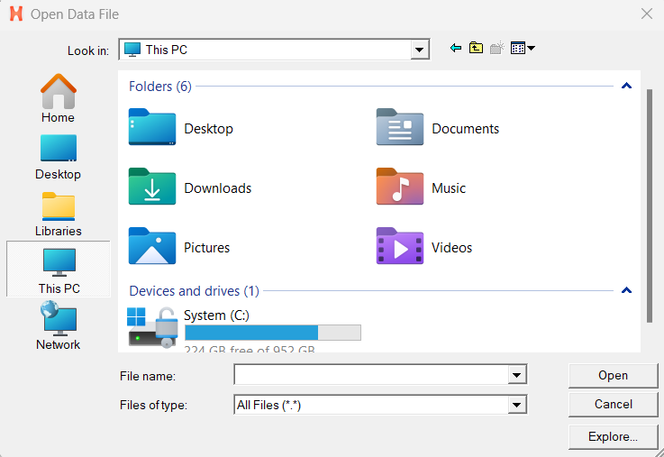

- Example showing the different versions of the File
Open dialog:
Figure 5.
Figure 6.
