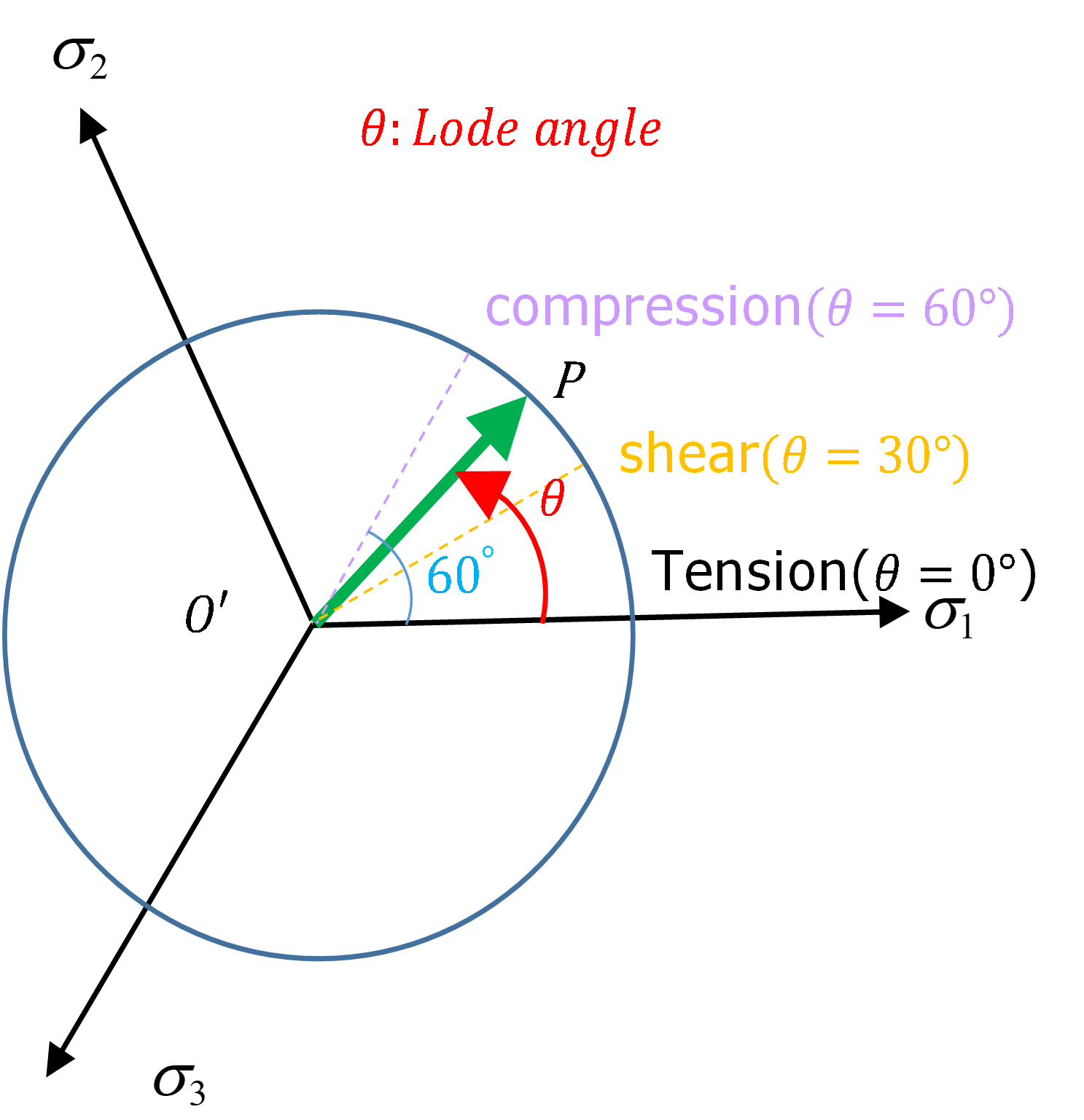

Lode Angle
To describe 3D loading conditions, another important quantity is the lode angle ( θ ) given by:
cos 3 θ = 27 2 J 3 σ V M 3 MathType@MTEF@5@5@+= feaahqart1ev3aaatCvAUfeBSjuyZL2yd9gzLbvyNv2CaerbuLwBLn hiov2DGi1BTfMBaeXatLxBI9gBaerbd9wDYLwzYbItLDharqqtubsr 4rNCHbGeaGqiVu0Je9sqqrpepC0xbbL8F4rqGqFfpeea0xe9vq=Jb9 vqpeea0xd9q8qiYRWxGi6xij=hbba9q8aq0=yq=He9q8qiLsFr0=vr 0=vr0db8meaabaqaciGacaGaaeqabaWaaeaaeaaakeaaciGGJbGaai 4BaiaacohadaqadaqaaiaaiodacqaH4oqCaiaawIcacaGLPaaacqGH 9aqpdaWcaaqaaiaaikdacaaI3aaabaGaaGOmaaaadaWcaaqaaiaadQ eadaWgaaWcbaGaaG4maaqabaaakeaacqaHdpWCdaqhaaWcbaGaamOv aiaad2eaaeaacaaIZaaaaaaaaaa@47AE@
Where J 3 MathType@MTEF@5@5@+= feaahqart1ev3aaatCvAUfeBSjuyZL2yd9gzLbvyNv2CaerbuLwBLn hiov2DGi1BTfMBaeXatLxBI9gBaerbd9wDYLwzYbItLDharqqtubsr 4rNCHbGeaGqiVu0Je9sqqrpepC0xbbL8F4rqGqFfpeea0xe9vq=Jb9 vqpeea0xd9q8qiYRWxGi6xij=hbba9q8aq0=yq=He9q8qiLsFr0=vr 0=vr0db8meaabaqaciGacaGaaeqabaWaaeaaeaaakeaacaWGkbWaaS baaSqaaiaaiodaaeqaaaaa@391C@ is the third deviatoric invariant.
The lode angle determines the position of the stress state in the deviatoric section. Its value is between 0 (for tension) and π / 3 MathType@MTEF@5@5@+= feaahqart1ev3aaatCvAUfeBSjuyZL2yd9gzLbvyNv2CaerbuLwBLn hiov2DGi1BTfMBaeXatLxBI9gBaerbd9wDYLwzYbItLDharqqtubsr 4rNCHbGeaGqiVu0Je9sqqrpepC0xbbL8F4rqGqFfpeea0xe9vq=Jb9 vqpeea0xd9q8qiYRWxGi6xij=hbba9q8aq0=yq=He9q8qiLsFr0=vr 0=vr0db8meaabaqaciGacaGaaeqabaWaaeaaeaaakeaacqaHapaCca GGVaGaaG4maaaa@3A91@ (for compression).
Figure 2. Stress state position on the deviatoric plane depending on the lode angle value
Shear and plane strain condition takes a lode angle value of π / 6 MathType@MTEF@5@5@+= feaahqart1ev3aaatCvAUfeBSjuyZL2yd9gzLbvyNv2CaerbuLwBLn hiov2DGi1BTfMBaeXatLxBI9gBaerbd9wDYLwzYbItLDharqqtubsr 4rNCHbGeaGqiVu0Je9sqqrpepC0xbbL8F4rqGqFfpeea0xe9vq=Jb9 vqpeea0xd9q8qiYRWxGi6xij=hbba9q8aq0=yq=He9q8qiLsFr0=vr 0=vr0db8meaabaqaciGacaGaaeqabaWaaeaaeaaakeaacqaHapaCca GGVaGaaGOnaaaa@3A94@ .

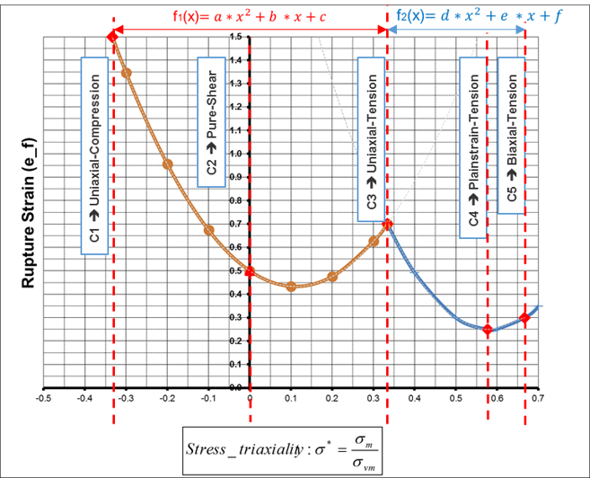

BIQUAD
The BIQUAD criterion is a stress triaxiality based failure criterion mostly used for ductile metals. Its double quadratic curve shape describes the evolution of plastic strain, ε p f MathType@MTEF@5@5@+= feaahqart1ev3aqatCvAUfeBSjuyZL2yd9gzLbvyNv2CaerbuLwBLn hiov2DGi1BTfMBaeXatLxBI9gBaerbd9wDYLwzYbItLDharqqtubsr 4rNCHbGeaGqiVu0Je9sqqrpepC0xbbL8F4rqqrFfpeea0xe9Lq=Jc9 vqaqpepm0xbba9pwe9Q8fs0=yqaqpepae9pg0FirpepeKkFr0xfr=x fr=xb9adbaqaaeGaciGaaiaabeqaamaabaabaaGcbaGaeqyTdu2aa0 baaSqaaiaadchaaeaacaWGMbaaaaaa@39A8@ , at failure with respect to stress triaxiality, η , as shown in the below image.
Figure 3. Failure plastic strain evolution with stress triaxiality for BIQUAD criterion
It then requires five parameters called c1, c2, c3, c4 and c5 respectively corresponding to V1, V2, V3, V4 and V5 value in the MATF Bulk Data Entry. These five values correspond to plastic strain at failure for five different stress states:
  1. Uniaxial compression
  2. Pure shear
  3. Uniaxial tension
  4. Plane strain
  5. Biaxial tension
Note: The parabolic curve computation at high stress triaxiality is made so that c4 is always the minimum value.

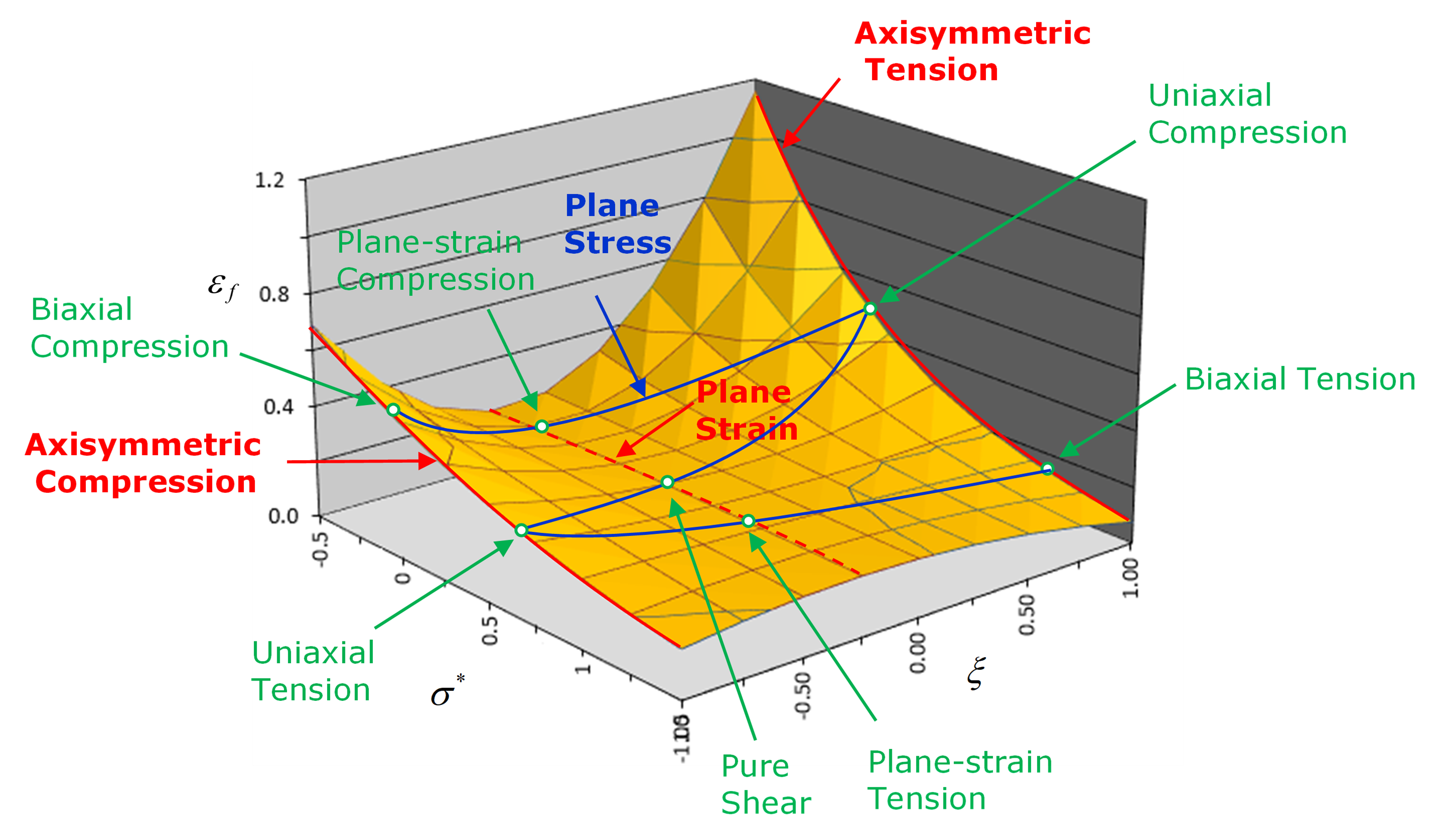

Tabulated failure criteria
The TAB failure criterion is used to give as much freedom as possible to describe a plastic strain based tabulated criterion. The TABLEMD entry defined by EPS_TID describes the map showing the evolution of plastic strain at failure, ε p f MathType@MTEF@5@5@+= feaahqart1ev3aqatCvAUfeBSjuyZL2yd9gzLbvyNv2CaerbuLwBLn hiov2DGi1BTfMBaeXatLxBI9gBaerbd9wDYLwzYbItLDharqqtubsr 4rNCHbGeaGqiVu0Je9sqqrpepC0xbbL8F4rqqrFfpeea0xe9Lq=Jc9 vqaqpepm0xbba9pwe9Q8fs0=yqaqpepae9pg0FirpepeKkFr0xfr=x fr=xb9adbaqaaeGaciGaaiaabeqaamaabaabaaGcbaGaeqyTdu2aa0 baaSqaaiaadchaaeaacaWGMbaaaaaa@39A8@ , with respect to stress triaxiality and, optionally for solid elements, with lode parameter, ξ , as shown in Figure 5.
Figure 5. Tabulated failure criterion map showing the evolution of plastic strain at failure with respect to stress triaxiality and lode parameter
For solid elements, the entire map with all possible couple of values, ( η , ξ ) MathType@MTEF@5@5@+= feaahqart1ev3aqatCvAUfeBSjuyZL2yd9gzLbvyNv2CaerbuLwBLn hiov2DGi1BTfMBaeXatLxBI9gBaerbd9wDYLwzYbItLDharqqtubsr 4rNCHbGeaGqiVu0Je9sqqrpepC0xbbL8F4rqqrFfpeea0xe9Lq=Jc9 vqaqpepm0xbba9pwe9Q8fs0=yqaqpepae9pg0FirpepeKkFr0xfr=x fr=xb9adbaqaaeGaciGaaiaabeqaamaabaabaaGcbaGaaiikaiabeE 7aOjaacYcacqaH+oaEcaGGPaaaaa@3B6C@ , is considered. However, for shells stress triaxiality and lode parameter are linked due to plane stress conditions. Hence, only the plane stress (blue line in Figure 5) is considered.

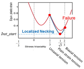

Another approach of stress softening approach with TAB criterion is called the necking-controlled approach.
To use this new approach, the two first parameters of the second line INST_TID and V6 must be defined. INST_TID defines the ID of a TABLEMD entry defining a map showing the evolution of the plastic strain value (denoted ε p l o c MathType@MTEF@5@5@+= feaahqart1ev3aqatCvAUfeBSjuyZL2yd9gzLbvyNv2CaerbuLwBLn hiov2DGi1BTfMBaeXatLxBI9gBaerbd9wDYLwzYbItLDharqqtubsr 4rNCHbGeaGqiVu0Je9sqqrpepC0xbbL8F4rqqrFfpeea0xe9Lq=Jc9 vqaqpepm0xbba9pwe9Q8fs0=yqaqpepae9pg0FirpepeKkFr0xfr=x fr=xb9adbaqaaeGaciGaaiaabeqaamaabaabaaGcbaGaeqyTdu2aa0 baaSqaaiaadchaaeaacaWGSbGaam4Baiaadogaaaaaaa@3B8A@ ) for which necking instability and thus strain localization starts, with respect to stress triaxiality and, optionally, lode parameter. It is an instability limit curve or map mostly defined at high stress triaxiality as the one described above for BIQUAD criterion in Figure 3 and is supposed to be lower than the failure curve/map to have an effect. It can be used with solids or shells.
This INST second map allows to compute the evolution of a new variable called necking-triggering variable and denoted f MathType@MTEF@5@5@+= feaahqart1ev3aqatCvAUfeBSjuyZL2yd9gzLbvyNv2CaerbuLwBLn hiov2DGi1BTfMBaeXatLxBI9gBaerbd9wDYLwzYbItLDharqqtubsr 4rNCHbGeaGqiVu0Je9sqqrpepC0xbbL8F4rqqrFfpeea0xe9Lq=Jc9 vqaqpepm0xbba9pwe9Q8fs0=yqaqpepae9pg0FirpepeKkFr0xfr=x fr=xb9adbaqaaeGaciGaaiaabeqaamaabaabaaGcbaGaamOzaaaa@36DF@ . Its evolution is very similar to the damage variable one:
f = ∑ t = 0 ∞ Δ ε p ε p l o c ( η , ξ ) ⋅ n ⋅ f 1 − 1 n MathType@MTEF@5@5@+= feaahqart1ev3aqatCvAUfeBSjuyZL2yd9gzLbvyNv2CaerbuLwBLn hiov2DGi1BTfMBaeXatLxBI9gBaerbd9wDYLwzYbItLDharqqtubsr 4rNCHbGeaGqiVu0Je9sqqrpepC0xbbL8F4rqqrFfpeea0xe9Lq=Jc9 vqaqpepm0xbba9pwe9Q8fs0=yqaqpepae9pg0FirpepeKkFr0xfr=x fr=xb9adbaqaaeGaciGaaiaabeqaamaabaabaaGcbaGaamOzaiabg2 da9maaqahabaWaaSaaaeaacqGHuoarcqaH1oqzdaWgaaWcbaGaamiC aaqabaaakeaacqaH1oqzdaqhaaWcbaGaamiCaaqaaiaadYgacaWGVb Gaam4yaaaakiaacIcacqaH3oaAcaGGSaGaeqOVdGNaaiykaaaaaSqa aiaadshacqGH9aqpcaaIWaaabaGaeyOhIukaniabggHiLdGccqGHfl Y1caWGUbGaeyyXICTaamOzamaaCaaaleqabaWaaeWaaeaacaaIXaGa eyOeI0YaaSaaaeaacaaIXaaabaGaamOBaaaaaiaawIcacaGLPaaaaa aaaa@594A@
Once this variable reaches the value 1, a stress softening is triggered (defined by Comment 12 in the MATF Bulk Data Entry). However, instead of using the constant value, D C MathType@MTEF@5@5@+= feaahqart1ev3aqatCvAUfeBSjuyZL2yd9gzLbvyNv2CaerbuLwBLn hiov2DGi1BTfMBaeXatLxBI9gBaerbd9wDYLwzYbItLDharqqtubsr 4rNCHbGeaGqiVu0Je9sqqrpepC0xbbL8F4rqqrFfpeea0xe9Lq=Jc9 vqaqpepm0xbba9pwe9Q8fs0=yqaqpepae9pg0FirpepeKkFr0xfr=x fr=xb9adbaqaaeGaciGaaiaabeqaamaabaabaaGcbaGaamiramaaBa aaleaacaWGdbaabeaaaaa@37B1@ , in the MATF entry, the parameter, D C MathType@MTEF@5@5@+= feaahqart1ev3aqatCvAUfeBSjuyZL2yd9gzLbvyNv2CaerbuLwBLn hiov2DGi1BTfMBaeXatLxBI9gBaerbd9wDYLwzYbItLDharqqtubsr 4rNCHbGeaGqiVu0Je9sqqrpepC0xbbL8F4rqqrFfpeea0xe9Lq=Jc9 vqaqpepm0xbba9pwe9Q8fs0=yqaqpepae9pg0FirpepeKkFr0xfr=x fr=xb9adbaqaaeGaciGaaiaabeqaamaabaabaaGcbaGaamiramaaBa aaleaacaWGdbaabeaaaaa@37B1@ , becomes an integration point. Thus D C MathType@MTEF@5@5@+= feaahqart1ev3aqatCvAUfeBSjuyZL2yd9gzLbvyNv2CaerbuLwBLn hiov2DGi1BTfMBaeXatLxBI9gBaerbd9wDYLwzYbItLDharqqtubsr 4rNCHbGeaGqiVu0Je9sqqrpepC0xbbL8F4rqqrFfpeea0xe9Lq=Jc9 vqaqpepm0xbba9pwe9Q8fs0=yqaqpepae9pg0FirpepeKkFr0xfr=x fr=xb9adbaqaaeGaciGaaiaabeqaamaabaabaaGcbaGaamiramaaBa aaleaacaWGdbaabeaaaaa@37B1@ can be very different from one element to another depending on the history of the element stress state.
Thus, when INST_TID is used, the D C MathType@MTEF@5@5@+= feaahqart1ev3aqatCvAUfeBSjuyZL2yd9gzLbvyNv2CaerbuLwBLn hiov2DGi1BTfMBaeXatLxBI9gBaerbd9wDYLwzYbItLDharqqtubsr 4rNCHbGeaGqiVu0Je9sqqrpepC0xbbL8F4rqqrFfpeea0xe9Lq=Jc9 vqaqpepm0xbba9pwe9Q8fs0=yqaqpepae9pg0FirpepeKkFr0xfr=x fr=xb9adbaqaaeGaciGaaiaabeqaamaabaabaaGcbaGaamiramaaBa aaleaacaWGdbaabeaaaaa@37B1@ value corresponds to the value taken by the damage variable D MathType@MTEF@5@5@+= feaahqart1ev3aqatCvAUfeBSjuyZL2yd9gzLbvyNv2CaerbuLwBLn hiov2DGi1BTfMBaeXatLxBI9gBaerbd9wDYLwzYbItLDharqqtubsr 4rNCHbGeaGqiVu0Je9sqqrpepC0xbbL8F4rqqrFfpeea0xe9Lq=Jc9 vqaqpepm0xbba9pwe9Q8fs0=yqaqpepae9pg0FirpepeKkFr0xfr=x fr=xb9adbaqaaeGaciGaaiaabeqaamaabaabaaGcbaGaamiraaaa@36BD@ at the exact moment when f MathType@MTEF@5@5@+= feaahqart1ev3aqatCvAUfeBSjuyZL2yd9gzLbvyNv2CaerbuLwBLn hiov2DGi1BTfMBaeXatLxBI9gBaerbd9wDYLwzYbItLDharqqtubsr 4rNCHbGeaGqiVu0Je9sqqrpepC0xbbL8F4rqqrFfpeea0xe9Lq=Jc9 vqaqpepm0xbba9pwe9Q8fs0=yqaqpepae9pg0FirpepeKkFr0xfr=x fr=xb9adbaqaaeGaciGaaiaabeqaamaabaabaaGcbaGaamOzaaaa@36DF@ reaches or overtakes the value 1. In other words, D C MathType@MTEF@5@5@+= feaahqart1ev3aqatCvAUfeBSjuyZL2yd9gzLbvyNv2CaerbuLwBLn hiov2DGi1BTfMBaeXatLxBI9gBaerbd9wDYLwzYbItLDharqqtubsr 4rNCHbGeaGqiVu0Je9sqqrpepC0xbbL8F4rqqrFfpeea0xe9Lq=Jc9 vqaqpepm0xbba9pwe9Q8fs0=yqaqpepae9pg0FirpepeKkFr0xfr=x fr=xb9adbaqaaeGaciGaaiaabeqaamaabaabaaGcbaGaamiramaaBa aaleaacaWGdbaabeaaaaa@37B1@ is the D MathType@MTEF@5@5@+= feaahqart1ev3aqatCvAUfeBSjuyZL2yd9gzLbvyNv2CaerbuLwBLn hiov2DGi1BTfMBaeXatLxBI9gBaerbd9wDYLwzYbItLDharqqtubsr 4rNCHbGeaGqiVu0Je9sqqrpepC0xbbL8F4rqqrFfpeea0xe9Lq=Jc9 vqaqpepm0xbba9pwe9Q8fs0=yqaqpepae9pg0FirpepeKkFr0xfr=x fr=xb9adbaqaaeGaciGaaiaabeqaamaabaabaaGcbaGaamiraaaa@36BD@ value when the necking criterion is reached the first time. Then, D C MathType@MTEF@5@5@+= feaahqart1ev3aqatCvAUfeBSjuyZL2yd9gzLbvyNv2CaerbuLwBLn hiov2DGi1BTfMBaeXatLxBI9gBaerbd9wDYLwzYbItLDharqqtubsr 4rNCHbGeaGqiVu0Je9sqqrpepC0xbbL8F4rqqrFfpeea0xe9Lq=Jc9 vqaqpepm0xbba9pwe9Q8fs0=yqaqpepae9pg0FirpepeKkFr0xfr=x fr=xb9adbaqaaeGaciGaaiaabeqaamaabaabaaGcbaGaamiramaaBa aaleaacaWGdbaabeaaaaa@37B1@ remains untouched until the end of the simulation.
D = ∫ Δ D f = ∫ Δ f D C = 1 while f < 1 D when f ≥ 1 σ = σ e f f 1 − D − D c 1 − D c exp MathType@MTEF@5@5@+= feaahqart1ev3aaatCvAUfeBSjuyZL2yd9gzLbvyNv2CaerbuLwBLn hiov2DGi1BTfMBaeXatLxBI9gBaerbd9wDYLwzYbItLDharqqtubsr 4rNCHbGeaGqiVu0Je9sqqrpepC0xbbL8F4rqqrFfpeea0xe9Lq=Jc9 vqaqpepm0xbba9pwe9Q8fs0=yqaqpepae9pg0FirpepeKkFr0xfr=x fr=xb9adbaqaaeGaciGaaiaabeqaamaabaabaaGceaqabeaacaWGeb Gaeyypa0Zaa8qaaeaacqGHuoarcaWGebaaleqabeqdcqGHRiI8aaGc baGaamOzaiabg2da9maapeaabaGaeyiLdqKaamOzaaWcbeqab0Gaey 4kIipaaOqaaiaadseadaWgaaWcbaGaam4qaaqabaGccqGH9aqpdaGa baqaauaabeqaceaaaeaafaqabeqadaaabaGaaGymaaqaaiaabEhaca qGObGaaeyAaiaabYgacaqGLbaabaGaamOzaiabgYda8iaaigdaaaaa baqbaeqabeWaaaqaaiaadseaaeaacaqG3bGaaeiAaiaabwgacaqGUb aabaGaamOzaiabgwMiZkaaigdaaaaaaaGaay5EaaaabaGaeq4WdmNa eyypa0Jaeq4Wdm3aaSbaaSqaaiaadwgacaWGMbGaamOzaaqabaGcda qadaqaaiaaigdacqGHsisldaqadaqaamaalaaabaGaamiraiabgkHi TiaadseadaWgaaWcbaGaam4yaaqabaaakeaacaaIXaGaeyOeI0Iaam iramaaBaaaleaacaWGJbaabeaaaaaakiaawIcacaGLPaaadaahaaWc beqaaiGacwgacaGG4bGaaiiCaaaaaOGaayjkaiaawMcaaaaaaa@6CE4@
Unlike the D C MathType@MTEF@5@5@+= feaahqart1ev3aqatCvAUfeBSjuyZL2yd9gzLbvyNv2CaerbuLwBLn hiov2DGi1BTfMBaeXatLxBI9gBaerbd9wDYLwzYbItLDharqqtubsr 4rNCHbGeaGqiVu0Je9sqqrpepC0xbbL8F4rqqrFfpeea0xe9Lq=Jc9 vqaqpepm0xbba9pwe9Q8fs0=yqaqpepae9pg0FirpepeKkFr0xfr=x fr=xb9adbaqaaeGaciGaaiaabeqaamaabaabaaGcbaGaamiramaaBa aaleaacaWGdbaabeaaaaa@37B1@ parameter, the exponent (EXP) is a constant parameter over all elements.
This necking-controlled approach can offer a higher predictivity for a large range of stress state but needs to define an instability map especially at high stress triaxiality when necking is more likely to happen.
