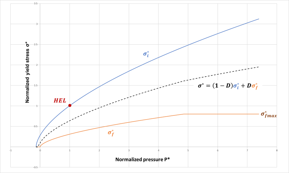

Optional continuation lines for Johnson-Holmquist model (for Explicit Dynamic Analysis only)
(1) (2) (3) (4) (5) (6) (7) (8) (9) (10)
JHOLMQ A B M N C RSTRT SMAX
T HEL PHEL D1 D2
K1 K2 K3 BETA

JHOLMQ Flag that identifies that the Johnson-Holmquist model parameters are to follow. 18
A Intact normalized strength constant.
No default (Real)
B Fractured normalized strength constant.
No default (Real)
M Fractured strength pressure exponent.
No default (Real)
N Intact strength pressure exponent.
No default (Real)
C Strain rate coefficient.
No default (Real)
RSTRT Reference strain rate.
No default (Real)
[1/s]
SMAX Maximum normalized fractured strength.
No default (Real)
T Maximum pressure tensile strength.
No default (Real)
[Pa]
HEL Hugoniot elastic limit.
No default (Real)
[Pa]
PHEL Pressure at Hugoniot elastic limit.
No default (Real)
[Pa]
D1 Damage constant.
No default (Real)
D2 Damage exponent.
No default (Real)
K1 Bulk modulus.
No default (Real)
[Pa]
K2 Pressure coefficient.
No default (Real)
[Pa]
K3 Pressure coefficient.
No default (Real)
[Pa]
BETA Bulking pressure coefficient.
No default (0.0 < Real <1.0)

  18. The Johnson-Holmquist material model is available to model brittle material behavior. It can be used with MAT1 elastic behavior and is currently only supported for solid elements. The shear modulus ( G ) and bulk modulus ( K 1 ) can be used to input the corresponding Young's modulus and Poisson's ratio as:
    E = 9 K 1 G 3 K 1 + G ν = 3 K 1 - 2 G 6 K 1 + 2 G
    The equivalent stress is the normalized Von Mises stress:
    σ V M * = 1 σ H E L 3 2 σ x x 2 + σ y y 2 + σ z z 2 + 2 σ x y 2 + 2 σ y z 2 + 2 σ z x 2
    Where the normalizing stress is the Hugoniot elastic limit is calculated as:
    σ H E L = 3 2 H E L - P H E L
    The normalized Von Mises stress, σ V M * is compared to the normalized yield stress σ * obtained with:
    σ * = 1 - D σ i * + D σ f *
    Where,
    σ i *
    Intact material yield stress: σ i * = a P * + T * n 1 + c ln ε ˙ ε ˙ 0
    α f *
    Failed material yield stress: σ f * = b P * m 1 + c ln ε ˙ ε ˙ 0 < σ f m a x *
    Where,
    σ *   =   σ σ H E L MathType@MTEF@5@5@+= feaahqart1ev3aaatCvAUfeBSjuyZL2yd9gzLbvyNv2CaerbuLwBLn hiov2DGi1BTfMBaeXatLxBI9gBaerbwvMCKfMBHbqee0evGueE0jxy aibaieYlf9irVeeu0dXdh9vqqj=hEeeu0xXdbba9frFj0=OqFfea0d Xdd9vqaq=JfrVkFHe9pgea0dXdar=Jb9hs0dXdbPYxe9vr0=vr0=vq pWqaaeaabiGaciaacaqabeaabiWacqaaaOqaaiabeo8aZjaacQcaca aMc8Uaeyypa0JaaGPaVpaalaaabaGaeq4WdmhabaGaeq4Wdm3aaSba aSqaaiaadIeacaWGfbGaamitaaqabaaaaaaa@414C@
    P * = P P H E L
    T * = T P H E L
    If no damage parameters are specified ( D 1 = D 2 = 0 ) , no plastic strain evolution is computed and an instant failure is obtained when the element behavior reaches the elastic limit. Otherwise, when damage parameters are mentioned, the plastic strain evolution is computed and the accumulated damage is:
    D = ∑ Δ ε f p ε f p
    Where the plastic strain to failure is calculated as:
    ε f p = D 1 P * + T * D 2
    The maximum pressure tensile strength is decreased during damage as:
    P * = - 1 - D T *
    This allows a smoother transition between σ i * and σ f * during damage.
    Figure 2. Evolution of Normalized Yield Stress with Respect to Normalized Pressure. Damage value of D = 0.5.
