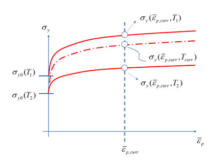

As an example, Figure 2 illustrates the principle of interpolation.
It is worthy to mention that the parameters (Q and B) are not interpolated directly. Instead, the yield functions at two temperatures are interpolated. This is the similar case for NLKIN, where the evolution laws at two temperatures are interpolated.
Figure 2. Principle of interpolation for temperature dependent NLISO
