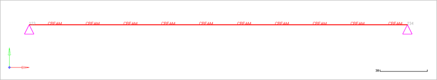

Benchmark Model
Rectangular cross-section CBEAM elements are used to model the simply-supported beam which consists of 10 elements. The displacements in x, y, and z direction are fixed at the end A and the displacements in y and z direction and the x rotations are constrained at end B. A Spectrum input in terms of acceleration, velocity and displacement is applied in the vertical direction at both supports. The damping is specified as zero for this problem.
