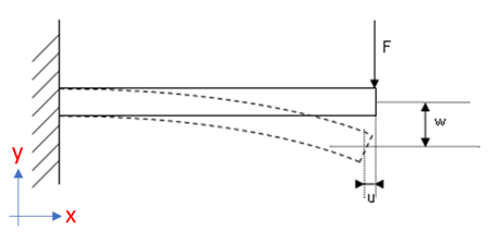

The beam is clamped at one end, and loaded with a concentrated force on the other end. The maximum vertical deflection is used for results comparison. This problem is well understood, and results can be easily compared with an analytical solution.

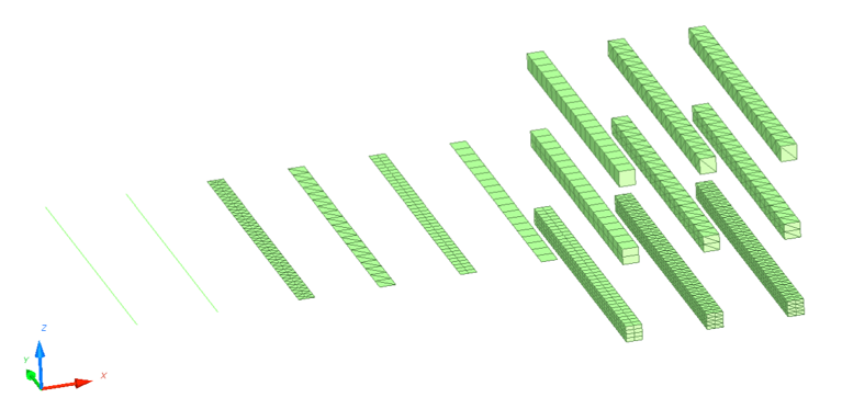

In this example, different mesh techniques are compared: beams, 3 and 4 noded shells, hexahedral elements and tetrahedral (tetra4 and tetra10) elements, as well as different element sizes.
The results are extracted and compared between each other with respect to their mesh size and element formulation. As output, the maximum vertical deflection, number of cycles, calculation time, element stress, and overall error are used. The maximum vertical deflection is compared to the theoretical value.

- 荷重ケース
- Fx = 0
この線形問題では、解析解で次の式が得られます:
- 力
- 梁の長さ
- ヤング率
- 慣性モーメント
理論的なたわみはw = 13.07mmと決定されます。
シミュレーションの反復
- /BEAM
- /SH3N
- /SHELL
- /BRICK
- /TETRA4
- /TETRA10

シェル要素(/PROP/TYPE1 (SHELL))の場合、QBAT-shell(Ishell = 12)とQEPH-shell(Ishell = 24)という2つの要素定式化が使用されます。
3次元ソリッド要素(/PROP/TYPE14 (SOLID))の場合、Isolid = 14、17、18、24というソリッド定式化が調査されます。
Tetra4要素の場合、Itetra4 = 0、1、3という定式化が使用され、Tetra10要素の場合、Itetra10 = 0、2という定式化が使用されます。
