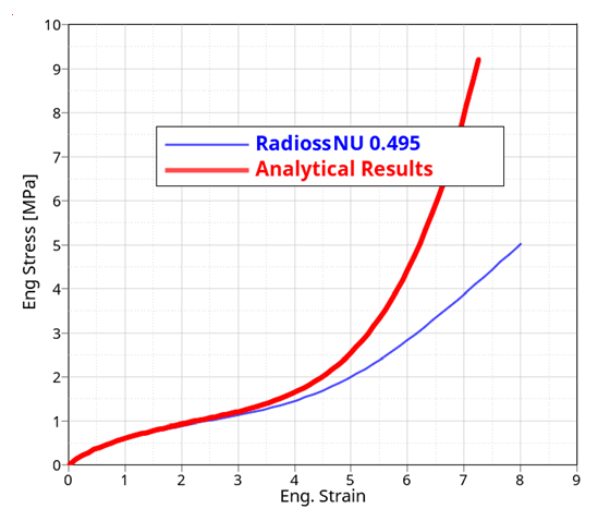

Compare the above results, then show the difference with analytical results
especially in high deformed area.
図 5 .

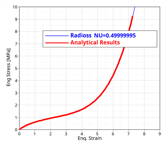

In order to match the incompressible hyperelastic analytical results, the Poisson’s
ratio needs to be defined as close to 0.5 as possible, but can not be simply defined
as
ν
=0
.5
MathType@MTEF@5@5@+=
feaagKart1ev2aaatCvAUfeBSjuyZL2yd9gzLbvyNv2CaerbuLwBLn
hiov2DGi1BTfMBaeXatLxBI9gBaerbd9wDYLwzYbItLDharqqtubsr
4rNCHbGeaGqiVu0Je9sqqrpepC0xbbL8F4rqqrFfpeea0xe9Lq=Jc9
vqaqpepm0xbba9pwe9Q8fs0=yqaqpepae9pg0FirpepeKkFr0xfr=x
fr=xb9adbaqaaeGaciGaaiaabeqaamaabaabaaGcbaGaeqyVd4Maae
ypaiaabcdacaqGUaGaaeynaaaa@3A8A@
, which will lead to infinite small time step in
numerical computation. In this example
ν
0.49999995
ypaabaaaaaaaaapeGaaGimaiaac6cacaaI0aGaaGyoaiaaiMdacaaI
5aGaaGyoaiaaiMdacaaI5aGaaGynaaaa@4009@
is used. It shows
Radioss results are well matched with analytical results.
