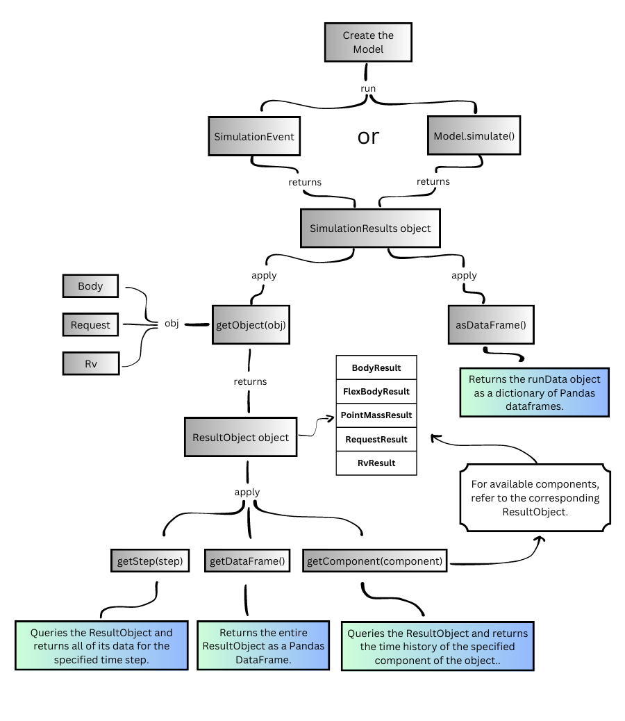

Result Objects#
msolve has special classes and methods to extract and store the results of a simulation. These objects provide a practical and convenient platform for post-processing.
The following process map explains the different ways you can obtain the results of a simulation.
Comments
Run a
SimulationEventor use theModel.simulatemethod with thereturnResultsset to True. This instructs msolve to store the results to aSimulationResultsobject.Use the
SimulationResults.asDataFramemethod to get the results as a dictionary of Pandas dataframes, or,Use the
SimulationResults.getObjectmethod, specifying the entity whose results are to be extracted. This entity can be aBody, aRequest, or aRv. AResultObjectis created, which can be one ofBodyResult,FlexBodyResult,PointMassResult,RequestResult,RvResult,FrfRequestResultorFrfBodyResultdepending on the entity.Use one of the methods
ResultObject.getStep,ResultObject.getDataFrame,ResultObject.getComponentto extract the numerical data of the entity.
Note
There is a wide range of libraries available in python for data post-processing, that can be used in conjunction with msolve.
