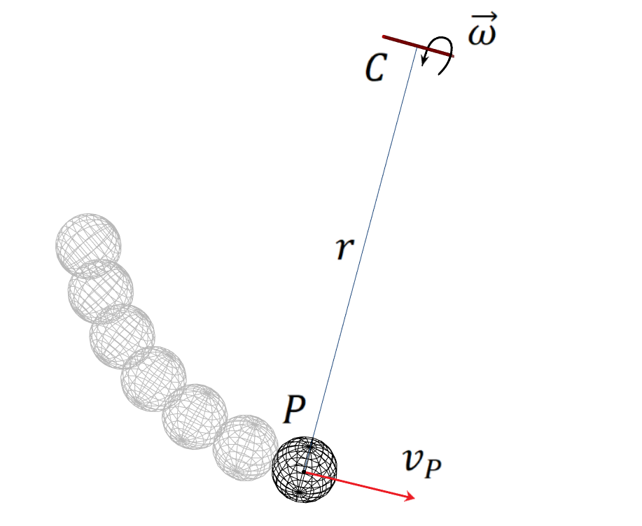

Thus, knowing the position of a point \(\vec{r_{P}}\) and its translational velocity \(\vec{\upsilon_{P}}\), we can find the closest point \(\vec{r_{C}}\) on the instantaneous axis of rotation by projecting the position of point \(P\) onto the angular velocity vector \(\vec{\omega}\). The closest point \(\vec{r_{C}}\) on the IAOR can be found using the following equation:
This equation calculates the point \(\vec{r_{C}}\) on the IAOR by projecting the velocity of point \(P\), \(\vec{r_{P}}\) onto the direction of the IAOR, represented by the angular velocity vector \(\vec{\omega}\).
Figure 1. The instantaneous axis of rotation for the pendulum example.#

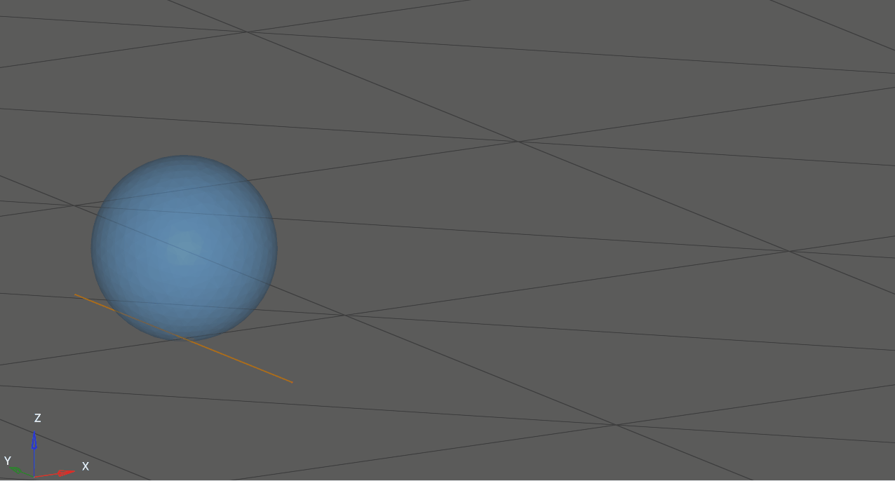

At any instant in time, a rolling body may be considered to be in pure rotation about the IAOR, which passes through the point of contact. The axis is translating forward with speed equal to the linear velocity of the rolling body’s center of mass.
Figure 2. The instantaneous axis of rotation for a purely-rolling sphere on a flat surface.#

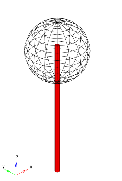

Using the above equations, the coordinates of a point on the instantaneous axis can be found, for which the distance between the body’s center of mass and said point is shortest. Similarly, we can determine the point for which the distance between the axis and the global origin is shortest. The line that connects these two points is the instantaneous axis of rotation.
In msolve, the axis is displayed as a meshed cylinder with its base featuring \(n\) number of nodes. For a purely rotating body, the axis will pass through its center of mass. For example, the instantaneous axis for a sphere of radius \(r = 5 mm\), located at \(z = 20 mm\), purely rotating about the global \(Z\) axis, having a base with \(n = 8\), is displayed as shown in Fig. 2 below.
Figure 3. The instantaneous axis of rotation for a purely-rotating sphere about the global Z axis.#
