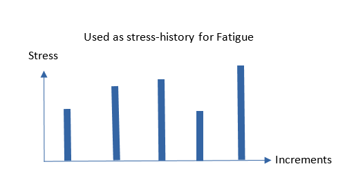

SN Fatigue Analysis
When SN fatigue analysis is carried out with nonlinear analysis results, fatigue damage is calculated in 3 different scenarios.
  • Nonlinear Analysis without Cyclic Load History in Fatigue Analysis
    If a TABFAT entry is not assigned to FATLOAD entry for Nonlinear Static Analysis based Fatigue analysis, then all incremental stresses are used in Fatigue analysis as if the stress at each load increment were stress at each time step. These incremental stresses are then used for Rainflow counting and subsequent damage calculations.
    Figure 1. SN Fatigue – Without TABFAT Cyclic Load History

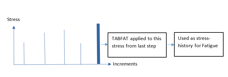

  • Nonlinear Analysis with Cyclic Load History in Fatigue Analysis
    If a TABFAT entry is assigned to FATLOAD entry for Nonlinear Static Analysis based Fatigue analysis, then the stress history is obtained from the load history of the TABFAT applied to stress at the last step of the nonlinear analysis. The load history is then used for Rainflow counting and subsequent damage calculations.
    Figure 2. SN Fatigue – With TABFAT Cyclic Load History

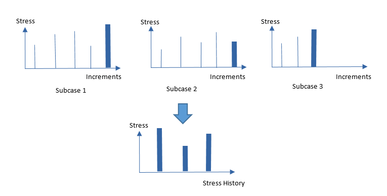

  • Nonlinear Analysis with SQNTL specified on FATEVNT for Fatigue Analysis
    If SQNTL is specified on the FATEVNT entry, then stress at the last step of each subcase is used to form a stress history. The number of increments does not need to be consistent across the different nonlinear subcases. This stress history is then used for Rainflow counting and subsequent damage calculations.
    Figure 3. SN Fatigue – With SQNTL on FATEVNT

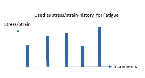

    If a TABFAT entry is not assigned to FATLOAD entry for Nonlinear Static Analysis based Fatigue analysis, then all incremental stresses and strains are used as if they were stresses and strains at each time step. In uniaxial fatigue, combined stress and strain are calculated using user-defined combination method. In multiaxial fatigue, the stresses and strains are directly fed to multiaxial fatigue calculations without going through Jiang-Sehitoglu plasticity models.
    Figure 4. EN Fatigue – Without TABFAT Cyclic Load History

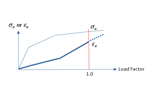

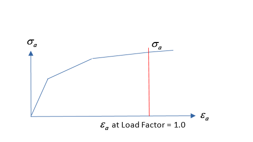

  • Nonlinear Analysis with Cyclic Load History in Fatigue Analysis and Monotonic load in nonlinear analysis
    If a TABFAT entry is assigned to FATLOAD entry for Nonlinear Static Analysis based Fatigue analysis, then a monotonic load is assumed for nonlinear analysis, and principal stress-principal strain relationship in an element/a grid of interest is calculated (Figure 5). The purpose of nonlinear analysis with monotonic load is to obtain material information required for EN fatigue analysis. The principal stress-principal strain relationship is considered as the cyclic stress-strain curve (Figure 6).
    Figure 5. EN Fatigue – Stress/Strain versus Load Factor
    Figure 6. EN Fatigue – Cyclic Stress-Strain Curve
    Rainflow counting is then performed on load-time history of the TABFAT entry assigned to the FATLOAD entry. Change of stress and strain ( Δ σ MathType@MTEF@5@5@+= feaagKart1ev2aqatCvAUfeBSjuyZL2yd9gzLbvyNv2CaerbuLwBLn hiov2DGi1BTfMBaeXatLxBI9gBaerbd9wDYLwzYbItLDharqqtubsr 4rNCHbGeaGqiVu0Je9sqqrpepC0xbbL8F4rqqrFfpeea0xe9Lq=Jc9 vqaqpepm0xbba9pwe9Q8fs0=yqaqpepae9pg0FirpepeKkFr0xfr=x fr=xb9adbaqaaeGaciGaaiaabeqaamaabaabaaGcbaGaeuiLdqKaeq 4Wdmhaaa@3920@ and Δ ε MathType@MTEF@5@5@+= feaagKart1ev2aqatCvAUfeBSjuyZL2yd9gzLbvyNv2CaerbuLwBLn hiov2DGi1BTfMBaeXatLxBI9gBaerbd9wDYLwzYbItLDharqqtubsr 4rNCHbGeaGqiVu0Je9sqqrpepC0xbbL8F4rqqrFfpeea0xe9Lq=Jc9 vqaqpepm0xbba9pwe9Q8fs0=yqaqpepae9pg0FirpepeKkFr0xfr=x fr=xb9adbaqaaeGaciGaaiaabeqaamaabaabaaGcbaGaeuiLdqKaeq yTdugaaa@3904@ ) with respect to change of load ( Δ l o a d MathType@MTEF@5@5@+= feaagKart1ev2aqatCvAUfeBSjuyZL2yd9gzLbvyNv2CaerbuLwBLn hiov2DGi1BTfMBaeXatLxBI9gBaerbd9wDYLwzYbItLDharqqtubsr 4rNCHbGeaGqiVu0Je9sqqrpepC0xbbL8F4rqqrFfpeea0xe9Lq=Jc9 vqaqpepm0xbba9pwe9Q8fs0=yqaqpepae9pg0FirpepeKkFr0xfr=x fr=xb9adbaqaaeGaciGaaiaabeqaamaabaabaaGcbaGaeuiLdqKaam iBaiaad+gacaWGHbGaamizaaaa@3B11@ ) in load-time history can be computed using the cyclic stress-strain curve as:
    Δ l o a d 2 → Δ ε 2 → Δ σ 2 MathType@MTEF@5@5@+= feaagKart1ev2aqatCvAUfeBSjuyZL2yd9gzLbvyNv2CaerbuLwBLn hiov2DGi1BTfMBaeXatLxBI9gBaerbd9wDYLwzYbItLDharqqtubsr 4rNCHbGeaGqiVu0Je9sqqrpepC0xbbL8F4rqqrFfpeea0xe9Lq=Jc9 vqaqpepm0xbba9pwe9Q8fs0=yqaqpepae9pg0FirpepeKkFr0xfr=x fr=xb9adbaqaaeGaciGaaiaabeqaamaabaabaaGcbaWaaSaaaeaacq qHuoarcaWGSbGaam4BaiaadggacaWGKbaabaGaaGOmaaaacqGHsgIR daWcaaqaaiabfs5aejabew7aLbqaaiaaikdaaaGaeyOKH46aaSaaae aacqqHuoarcqaHdpWCaeaacaaIYaaaaaaa@4785@
    By accumulating change of the stress and strain, you can find the complete stress history and strain history with respect to the load history. This process is as good as the combination of Ramberg-Osgood equation and Neuber correction in damage calculation with linear analysis results.
    The Rainflow cycle counting starts from the maximum absolute valley or peak of the load. The stress-strain relationship is only valid until load factor becomes 1.0. Thus the initial loading which is the absolute maximum valley or peak is not supposed to be greater than 1.0. This implies that the absolute maximum value of the load history should be ideally less than or equal to 1.0 after the scale and offset are applied. If the absolute maximum value of the load history is greater than 1.0, extrapolated stress and strain are used for an initial loading point as depicted (Figure 6). Likewise, extrapolated Δ ε 2 MathType@MTEF@5@5@+= feaagKart1ev2aqatCvAUfeBSjuyZL2yd9gzLbvyNv2CaerbuLwBLn hiov2DGi1BTfMBaeXatLxBI9gBaerbd9wDYLwzYbItLDharqqtubsr 4rNCHbGeaGqiVu0Je9sqqrpepC0xbbL8F4rqqrFfpeea0xe9Lq=Jc9 vqaqpepm0xbba9pwe9Q8fs0=yqaqpepae9pg0FirpepeKkFr0xfr=x fr=xb9adbaqaaeGaciGaaiaabeqaamaabaabaaGcbaWaaSaaaeaacq qHuoarcqaH1oqzaeaacaaIYaaaaaaa@39D0@ and Δ σ 2 MathType@MTEF@5@5@+= feaagKart1ev2aqatCvAUfeBSjuyZL2yd9gzLbvyNv2CaerbuLwBLn hiov2DGi1BTfMBaeXatLxBI9gBaerbd9wDYLwzYbItLDharqqtubsr 4rNCHbGeaGqiVu0Je9sqqrpepC0xbbL8F4rqqrFfpeea0xe9Lq=Jc9 vqaqpepm0xbba9pwe9Q8fs0=yqaqpepae9pg0FirpepeKkFr0xfr=x fr=xb9adbaqaaeGaciGaaiaabeqaamaabaabaaGcbaWaaSaaaeaacq qHuoarcqaHdpWCaeaacaaIYaaaaaaa@39EC@ are used for change of stress and strain if Δ l o a d 2 MathType@MTEF@5@5@+= feaagKart1ev2aqatCvAUfeBSjuyZL2yd9gzLbvyNv2CaerbuLwBLn hiov2DGi1BTfMBaeXatLxBI9gBaerbd9wDYLwzYbItLDharqqtubsr 4rNCHbGeaGqiVu0Je9sqqrpepC0xbbL8F4rqqrFfpeea0xe9Lq=Jc9 vqaqpepm0xbba9pwe9Q8fs0=yqaqpepae9pg0FirpepeKkFr0xfr=x fr=xb9adbaqaaeGaciGaaiaabeqaamaabaabaaGcbaWaaSaaaeaacq qHuoarcaWGSbGaam4BaiaadggacaWGKbaabaGaaGOmaaaaaaa@3BDD@ is greater than 1.0.

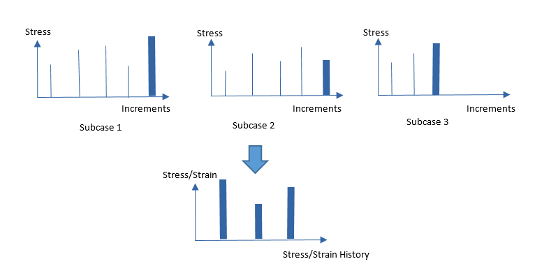

    If SQNTL is specified on the FATEVNT entry, then stress at the last step of each subcase is used to form a stress history and a strain history. The number of increments does not need to be consistent across the different nonlinear subcases.
    Figure 7. EN Fatigue – With SQNTL on FATEVNT
