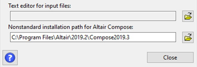

External Responses using Altair Compose
Invoking Compose to specify the installation path.
If Altair Compose needs to be invoked during the OptiStruct job in case of external responses (DRESP3), the installation path for Compose must to be specified by the user.
There are 2 methods to specify the installation path from the Compute Console (ACC).
  • Edit > Preferences
  • Options field
For further details, refer to -compose in Run Options.

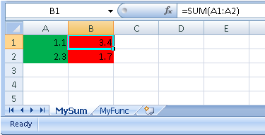

Implicit Definition
This is a simple implementation wherein two columns in an Excel worksheet are used to define the input and output parameters. Column 1 can be used to list input parameters and Column 2 can be used to list output parameters.
LOADLIB DRESP3    ELIB    dresp3_excel.xlsx
DRESP3       10      SUM    ELIB   MYSUM
+        DRESP1        5       6
Figure 4.
response_implicit

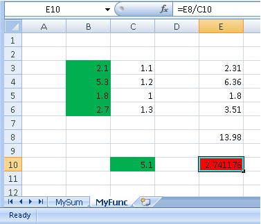

Explicit Definition
In this advanced implementation, the cell input number is specified. Cells for input and output data are listed.
DRESP3       20   FUNC    ELIB  MYFUNC
+        DRESP1      5       6       7      8
+        DESVAR      1
+        CELLIN     B3     THRU     B6
+        CELLIN    C10
+        CELLOUT   E10
Figure 5.
response_explicit
