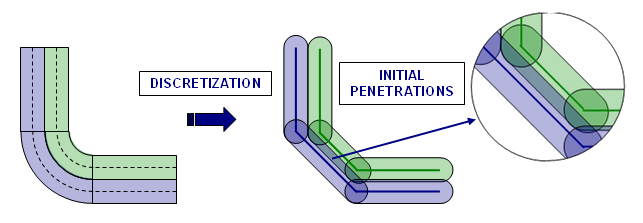

In an FE model, initial penetrations are very common, are unavoidable and result from the discretization during the meshing process (Figure 1).
Figure 1. Initial Penetrations Due to Discretization

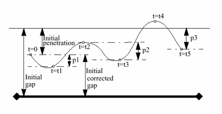

It is also possible to obtain a variable gap in time by setting Inacti to 5. The illustration Figure 2 explains how the effective gap is updated taking into account the previous penetrations.
Figure 2. Variable Gap in Time

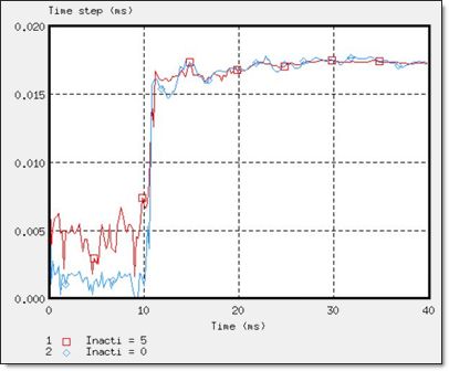

At t=0, if a node is initially penetrated, its gap is automatically corrected. Then this "initial corrected gap" will be increased every time the node is moving away from the main segment. This option is mainly used for unfolding the airbag, it allows a decent time step at the beginning of the unfolding, whereas nodes are all highly penetrated.
Figure 3. Time Step Using Inacti=5
To avoid high frequency effects Inacti = 6 is recommended instead of Inacti =5.

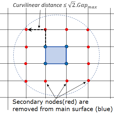

Irem_gap
The option Irem_gap is used to deactivate secondary nodes which close (Curvilinear D i s t a n c e < 2 ⋅ G a p ) to elements. This option is useful for self-impact contact when mesh size is very small.
Figure 4. -1: Irem_gap Definition
