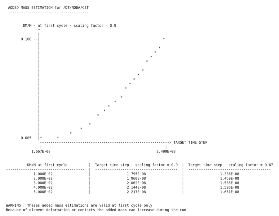

Choose a Time Step for Mass Scaling
To determine how much mass will be added to a model, Radioss calculates a target time step for different amounts of percent mass increase. The target time step is calculated for percent mass increases from 0.5% to 10% for time step scale factors ( Δ T sca ) of 0.9 and 0.67. This information is printed in a table and a graph in the Starter output file.
Note: This estimation is valid at first cycle only. The added mass can increase during the run because of element deformation or contacts which means the added mass can become higher than the value expected from the Starter estimation.
Figure 1. Mass Added for Different Target Time Steps
The target time step and scale factor can then used in /DT/NODA/CST.
