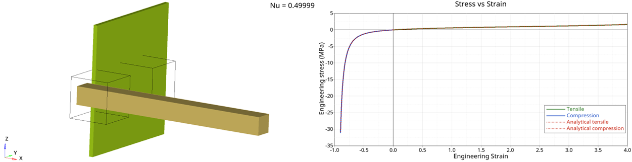

    C 10 =0.18 C 20 =-2e -3 C 30 = 5 e − 5
    Figure 3. Engineer stress-strain curve for Poisson ratio ν = 0 . 5
  • /MAT/LAW94:

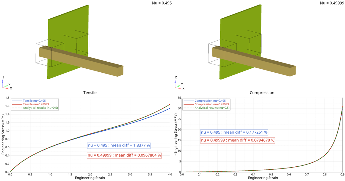

The analytical results are compared with the Radioss results below:
Table 1.
Poisson's Ratio D1
ν = 0 . 495 (default value) 17.94011589315
ν = 0 . 49999 (to be as close to analytical value with ν = 0 . 5 8999.928000576
Figure 4.
Both models return results very close to the analytical results.
The model with ν =0 .495 MathType@MTEF@5@5@+= feaagKart1ev2aaatCvAUfeBSjuyZL2yd9gzLbvyNv2CaerbuLwBLn hiov2DGi1BTfMBaeXatLxBI9gBaerbd9wDYLwzYbItLDharqqtubsr 4rNCHbGeaGqiVu0Je9sqqrpepC0xbbL8F4rqqrFfpeea0xe9Lq=Jc9 vqaqpepm0xbba9pwe9Q8fs0=yqaqpepae9pg0FirpepeKkFr0xfr=x fr=xb9adbaqaaeGaciGaaiaabeqaamaabaabaaGcbaGaeqyVd4Maae ypaiaabcdacaqGUaGaaeynaaaa@3A8A@ shows higher differences for the large tensile deformation (> 200%).
The time step and computation time is larger for the model with ν = 0.49999 MathType@MTEF@5@5@+= feaagKart1ev2aaatCvAUfeBSjuyZL2yd9gzLbvyNv2CaerbuLwBLn hiov2DGi1BTfMBaeXatLxBI9gBaerbd9wDYLwzYbItLDharqqtubsr 4rNCHbGeaGqiVu0Je9sqqrpepC0xbbL8F4rqqrFfpeea0xe9Lq=Jc9 vqaqpepm0xbba9pwe9Q8fs0=yqaqpepae9pg0FirpepeKkFr0xfr=x fr=xb9adbaqaaeGaciGaaiaabeqaamaabaabaaGcbaGaeqyVd4Maae ypaabaaaaaaaaapeGaaGimaiaac6cacaaI0aGaaGyoaiaaiMdacaaI 5aGaaGyoaiaaiMdacaaI5aGaaGynaaaa@4009@ due to the larger bulk modulus. The results of this model are closer to the analytical results.
