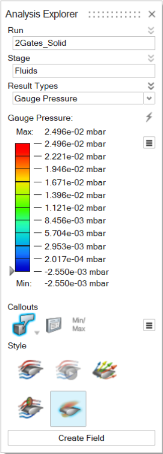

Analysis Explorer Options
The Analysis Explorer includes the following options.
Run
To delete a run from the Analysis Explorer, right-click the run name to select Delete Run.

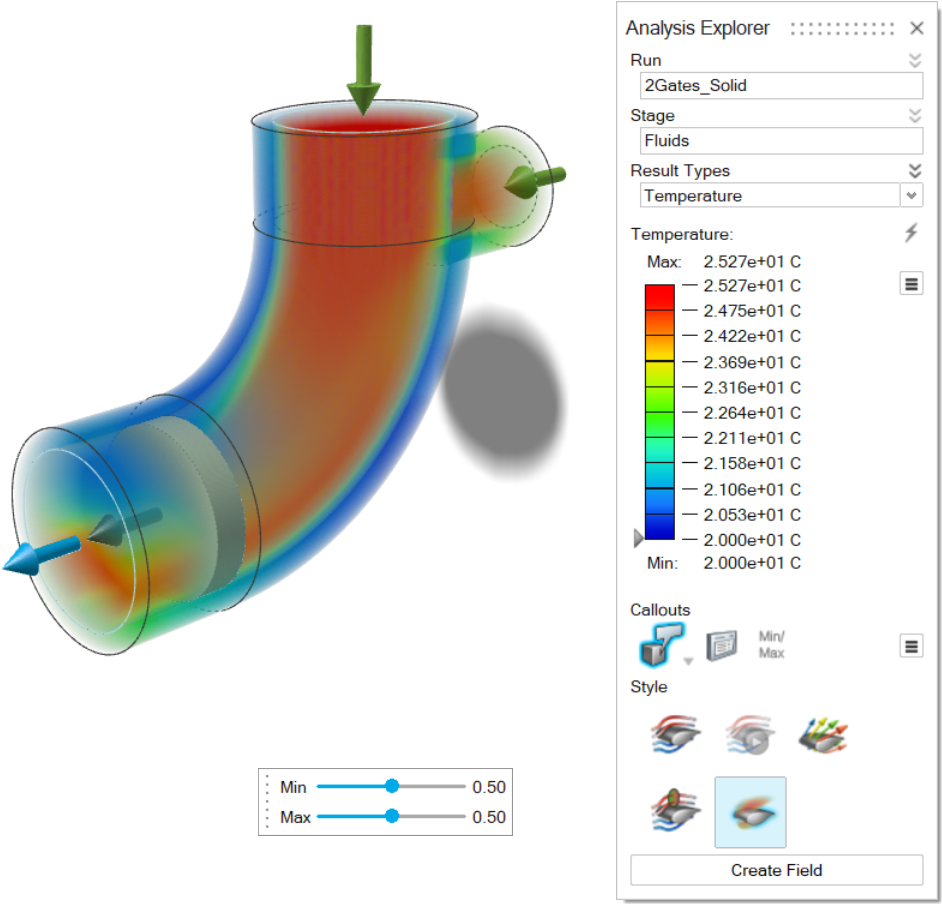

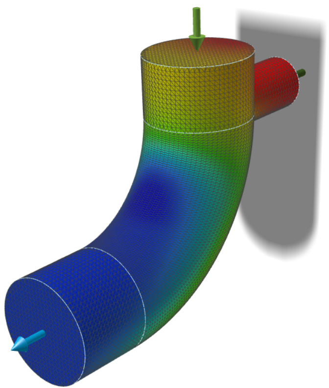

Result Types
Gauge Pressure
Velocity
Temperature
Results Slider
| To | Do this |
| Change the upper or lower bound for the results slider | Click the bound and enter a new value. Click the button to restore the default
values. |
| Filter the results so that areas on the model with results greater than a specified value are masked | Click and drag the arrow on the results slider. To mask areas
with results less than the specified value, click |
| Change the legend color for the result type | Click the |
| Enable the legend's maximum and minimum values to change for each animation step | Click the |
| Reverse the default meaning of results slider colors Note: By default, red indicates high, green
indicates medium, and blue indicates low. |
Click the |

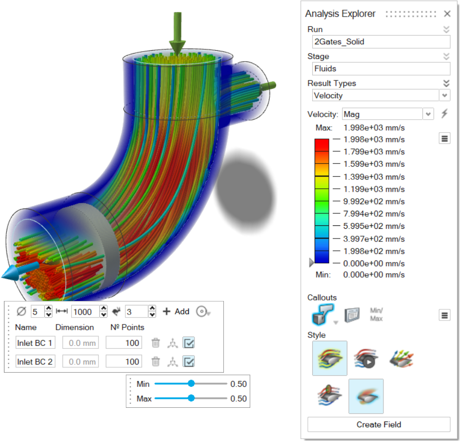

Style Options
Visualize the results as static streamlines, animated streamlines, or vectors. You can also make edits to the streamlines or vectors.
| Option | Description | Microdialog Options |
| Static Streamlines |
Visualize the results as static streamlines.
To access the microdialog options for streamlines, select the
Static Streamline icon
| Animated Streamlines |
Only available if Streamlines is turned
on. Click the icon once to visualize the results as animated streamlines. Click the icon again to jump to the end of the animation.
| Vectors |
Visualize the results as vectors.
To access the microdialog options for vectors, select the
Vectors icon
Use the microdialog options to edit the vectors:
| Integration Sections |
Visualize average velocity/flow rate through a section of the fluid
domain. ![]() |
To access the microdialog options for Integration Sections, select
the Integration Sections icon ![]() Use the microdialog options to create and edit sections. ![]() Use the move tool to translate, rotate, and resize sections. |
| Enable Transparency
Render the model transparent to a greater or lesser degree. This is useful when observing the interior of a model in full three-dimensional view without using section cuts. | Use the sliders in the microdialog to change the transparency of the minimum and maximum areas the current result type. |
