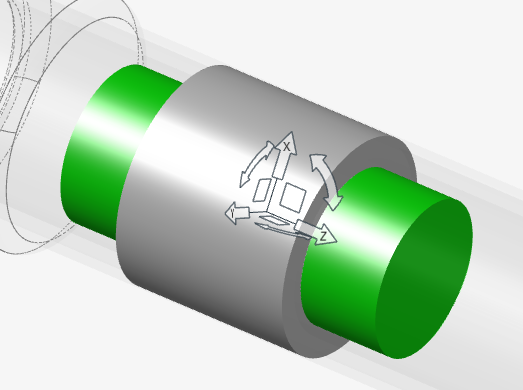

Joint editing options are listed below:To Do this Notes Change the joint's type In the microdialog, select a joint type from the dropdown menu. The joint can be changed to any type regardless of the type of joint Inspire creates based on detected geometry. Translate or rotate the joint In the microdialog, select the Move tool
Drag the white arrows, or enter a value for X, Y, or Z to translate or rotate the joint.
Reset the joint to its original location and orientation In the microdialog, select the Reset

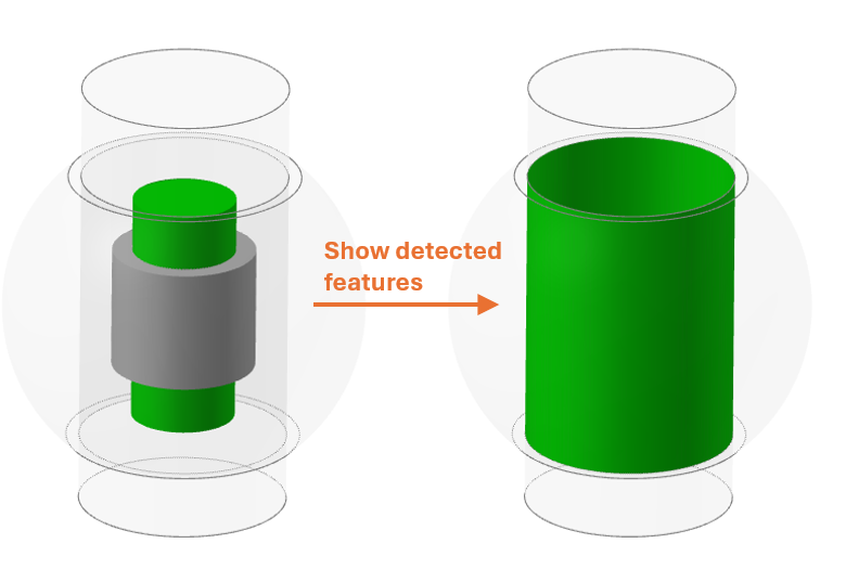

Auto-fit the joint In the Joints edit context, click on the joint, then click the white arrow. Click
in the microdialog.Display the joints as detected features In the microdialog, select
Show
Detected Features.
Only available for Hinge, Cylindrical, Translational, Ball and Socket, Planar, and Unknown joints. Limit the distance or angle a joint can translate or rotate In the microdialog, turn on Limits.

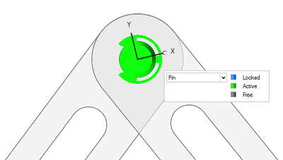

Microdialog Options
Use the options in the microdialog to change the joint type and how it is constrained.
- Joint Type
- Joints are available in a variety of types such as Pin, Hinge, or Ball and Socket. The most likely joint type, which is based on the detected features, will be automatically selected. The joint type can then be changed to any type you would like.
- Joint State
- Each joint has a state which can be set to Locked, Active, or Free.
- Select Locked to prevent movement in the joint.
- Select Free if you want the mechanism to
behave as if the joint is not there.Note: Refer to Joint Types and States for more information.
- Move Tool
- Select
to open the move tool for the joint. Translate
or rotate the joint using the white arrows, or by entering a value for X, Y,
or Z. - Reset
- Select
to reset the joint to its original location and
orientation.
- Show Detected Features
- Select select
to display the joints as detected
features. Only available for Hinge, Cylindrical, Translational, Ball and

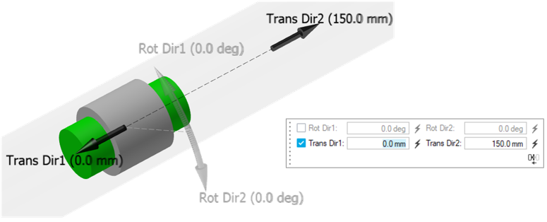

- Limits
- Turn on this option to limit the distance or angle a joint can translate or
rotate. Only available for Hinge, Cylindrical, Translational, Ball and
Socket, Planar, and pin-based joints.

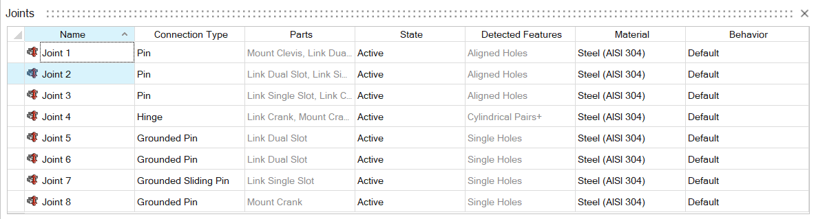

Joints Table
The Joints table lists all of the joints in your model including the type of connection, the parts it connects, and the assigned material.
Click the
satellite icon on the Joints tool to display the table.
The table data can be edited with the following actions:
| To | Do this |
| Rename a joint | Select the cell in the table and then click again to make the field editable. |
| Change the connection type, state, material, or behavior | Select the cell in the table and then select a different option from the list. |
| Sort a column | Click the column header. Click repeatedly to toggle between ascending and descending order. |
| Add or remove columns | Right-click on a column header. |
