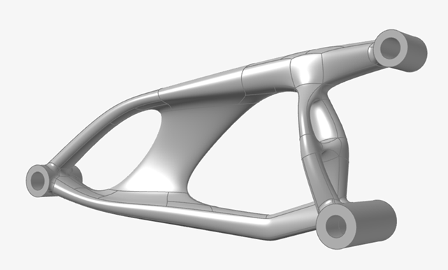

This is a solid model of a single-part motorcycle swing arm.

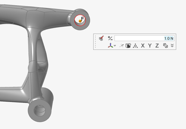

On the Structure ribbon, click the Force
button in the Loads tool group.
Tip: To find and open a tool, press Ctrl+F. For more information, see Find and Search for Tools. -

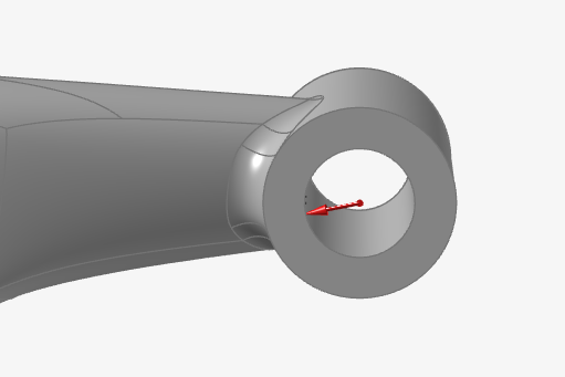

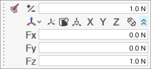

Click to apply the force to the hole center of the shock mount.
Switch to Component Mode
on the
microdialog, and click the
chevron to expand it.
Enter the following values:
- Fx: -2352 N
- Fy: 3211 N
- Fz: -635 N

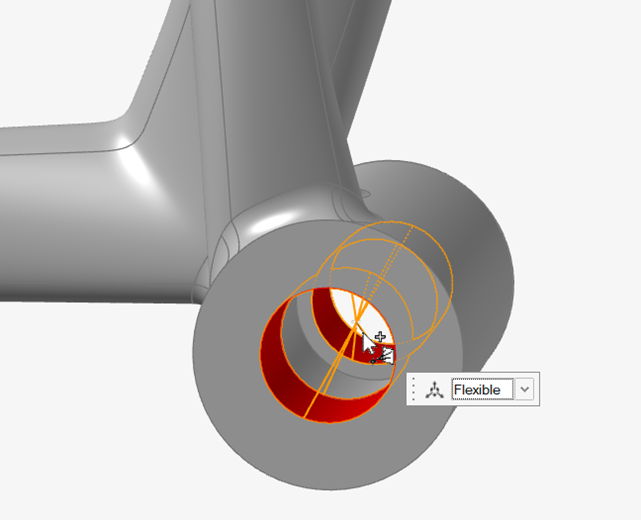

Apply a Component Force and Moment to the Swing Arm Pivot
- Zoom in on the swing arm pivot.
On the Structure ribbon, select the Connectors
tool.
Select the two faces as shown below to create a connector at the center of the
hole:

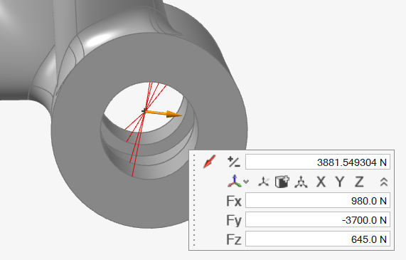

Switch to
Component Mode
on the
chevron
to expand it.
- Fx: 980 N
- Fy: -3700 N
- Fz: 645 N

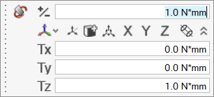

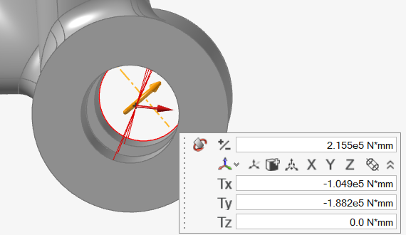

On the Structure ribbon, click the Torque
on the
chevron
to expand it.
- Tx: -104867 N*mm
- Ty: -188238 N*mm
- Tz: 0 N*mm

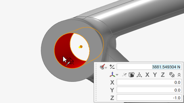

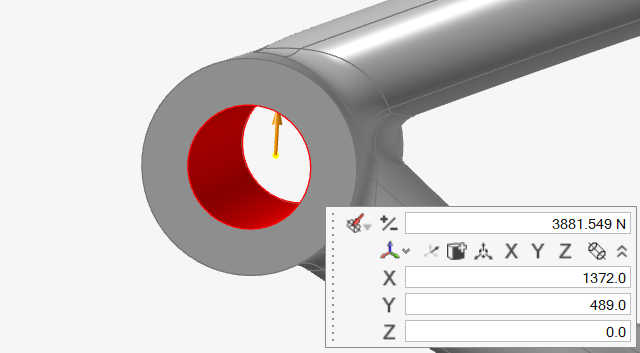

Select the face as shown below to apply a force to the hole center of the
axle.
Switch to
Component Mode
on the
chevron
to expand it.
- Fx: 1372 N
- Fy: 489 N
- Fz: 0 N

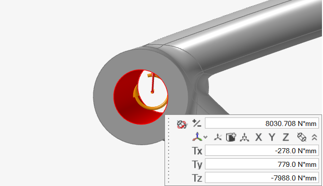

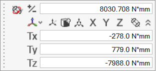

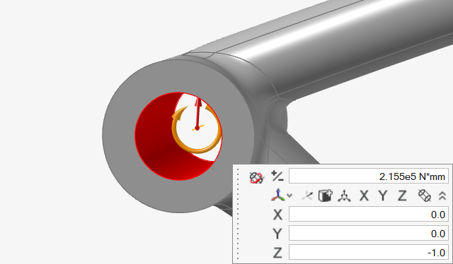

button in
Select the face shown below to apply a torque to the hole center of the
axle.
on the
chevron
to expand it.
- Tx: -278 N*mm
- Ty: 779 N*mm
- Tz: -7998 N*mm

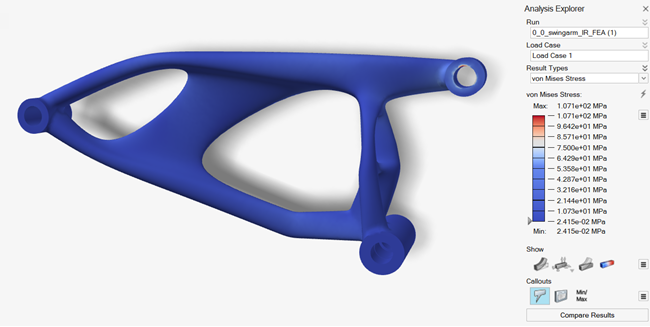

Run an Analysis with Inertia Relief
the Run OptiStruct Analysis
button in the
Analyze tool group.

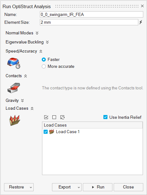

Run the analysis using the following settings:
- Change the Element size to 2 mm.
- Set Speed/Accuracy is set to Faster.
- Click Load Cases and select Use Inertia Relief.
- Click Run to perform the analysis.

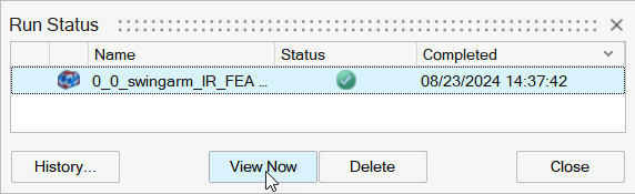

When the run is complete, select it in the Run Status window and click
View Now to view the results.
In the Analysis Explorer, select von Mises Stress from
the Result Types dropdown.
Note: Even without supports, the analysis runs as any imbalance in the loads is reacted by the inertia forces.
