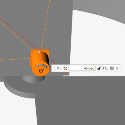

Add Angle Motor(s) to Control Part Angles
Select the Motors tool.
Rotate the model to see the underside of the Base part.
For the first connection, click the Cen (center) snap point on the circular
face of the Mount 1 part.
The selected feature turns red. This is the shaft connection point.
Click on the Base part.
This is the base connection for the motor.A motor appears and the microdialog has the default setting of being a speed motor.
In the microdialog, change the motor Type from Speed to
Angle.
Notice that the magnitude field now contains 45 degrees as the default
angle.
Click the +/- button to reverse the direction of the
motor's rotation.
Change the Profile Function to Step Dwell
Step.
