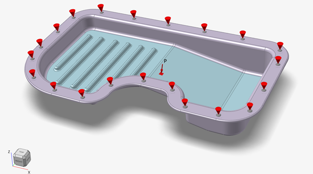

- Press F7 to open the Demo Browser.
Double-click the baseline_oilpan.stmod file to load it in
the modeling window. Note that it has a pressure applied to the base part and is
restrained with fasteners at the bolt holes.

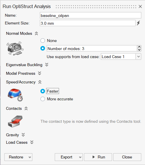

Run the analysis using the following settings:
- Change the Element Size to 3.0 mm.
- Under Normal Modes, select Number of modes: 3.
- Select Load Case 1 from the Use supports from load case dropdown.
- Set Speed/Accuracy to Faster.
- Click Run to perform the analysis.

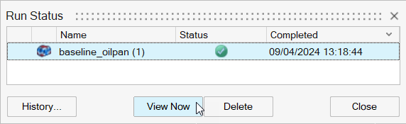

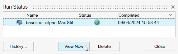

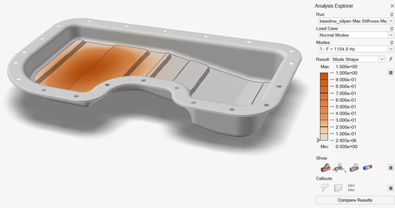

When the run is complete, select it in the Run Status window and click View
Now to see the results.
In the Analysis Explorer, click Show Selected Load Case
and select
Hide all Loads and Supports

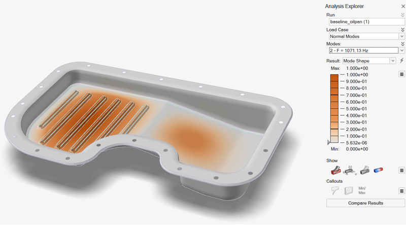

In the Analysis Explorer, select Normal Modes from the
Load Case dropdown and review the modes.

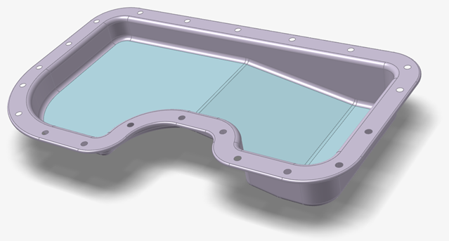

The best starting point for topography optimization is a design region without complex definition within the CAD. In many cases, the Holes tool can be used to remove existing beads and fill in holes.
On the Geometry ribbon, click the Simplify
tool, and then click the Holes
tool on the secondary ribbon.
Tip: To find and open a tool, press Ctrl+F. For more information, see Find and Search for Tools. -

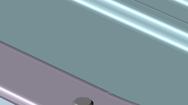

Click the Reset
button on the guide bar.

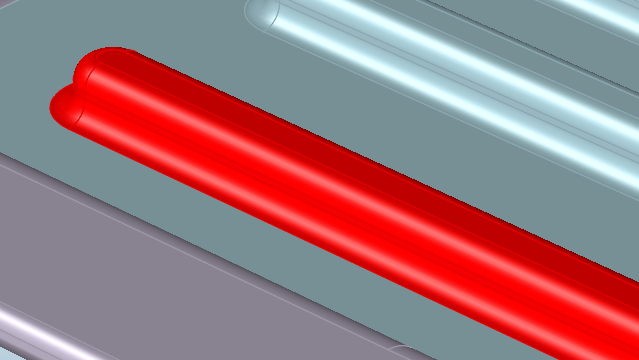

Zoom in on one of the beads and double-click one of the bottom fillets (nearest
the bottom of the oil pan).
This will chain select the entire bead.
Click on one of the selected red faces to remove the entire bead.
Repeat the procedure to remove the remaining beads on the oil pan.
Tip: Alternatively, you can open the defeatured_oilpan.stmod file to load it in the modeling window. - Right-click and mouse through the check mark to exit, or double-right-click.

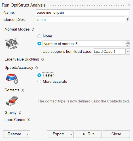

- Make sure that Speed/Accuracy is set to Faster.

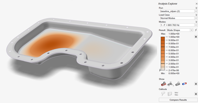

Note: The local mode shape where the beads were removed decreased from 1071 Hz to 693 Hz.

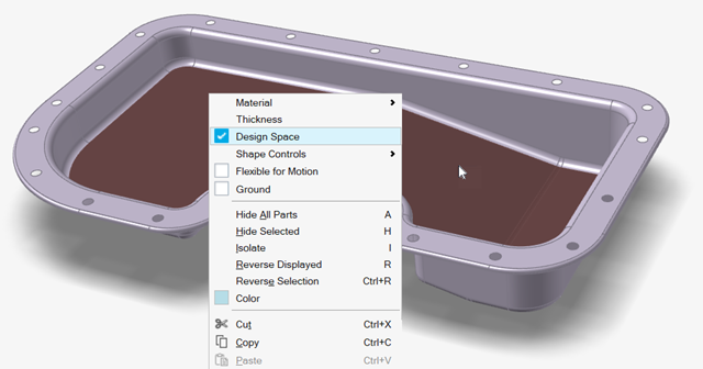

Right-click on the base part to open the context menu, and select
Design Space.

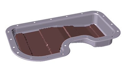

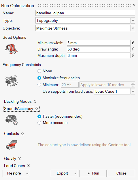

On the Structure ribbon, click the Run Optimization
button in the Optimize tool
group.
Run the optimization using the following settings:

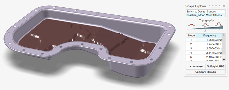

In the Shape Explorer, note that Mode 1 has increased to 1268 Hz with a lower
bead height than in the original part.
Note: Interpreting the results of topography optimization is often helped by performing multiple runs with different bead option parameters and bead patterns. This highlights key areas that benefit from the extra form and increased section modulus that typically result from topology optimization.

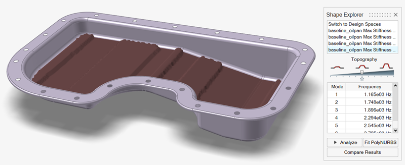

Linear, circular, and radial bead patterns are sometimes desired for manufacturing or other reasons. These bead patterns can be applied using the Bead Pattern tool.
In the Shape Explorer, select Switch to Design
Spaces.
On the Structure ribbon, click the Bead Patterns
tool,
and then click the Linear

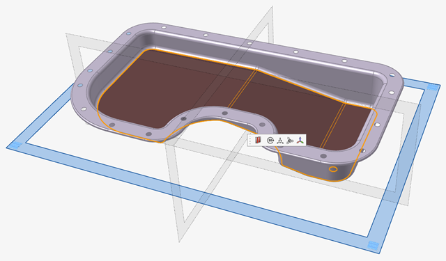

- Select the base of the oil pan.
Set the plane of symmetry as shown. Click the Rotate 90
Degrees
button on the microdialog if needed to change the
direction of the beads.
button in the
Optimize tool group.
Rerun the topography optimization with the same parameters as before:
Note: Note the linear alignment of the beads to the defined vector. Also note that Mode 1 is now 1165 Hz. This is better than the baseline result, but not as high as the initial optimization run.

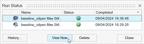

In the Shape Explorer, click the Analyze button to
analyze the generated shape.
