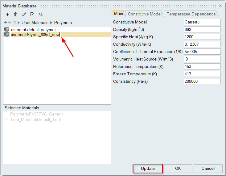

From the Polymers ribbon, click the
Materials tool.
In the Material Database dialog, right-click in the dialog
and select Fit Material.
Select the file and click OK.
A material file is created inside the selected folder.
Copying Materials
Use the Materials tool to copy materials.
the Materials tool.
In the Material Database dialog, right-click on the
material and select Copy to user area.
