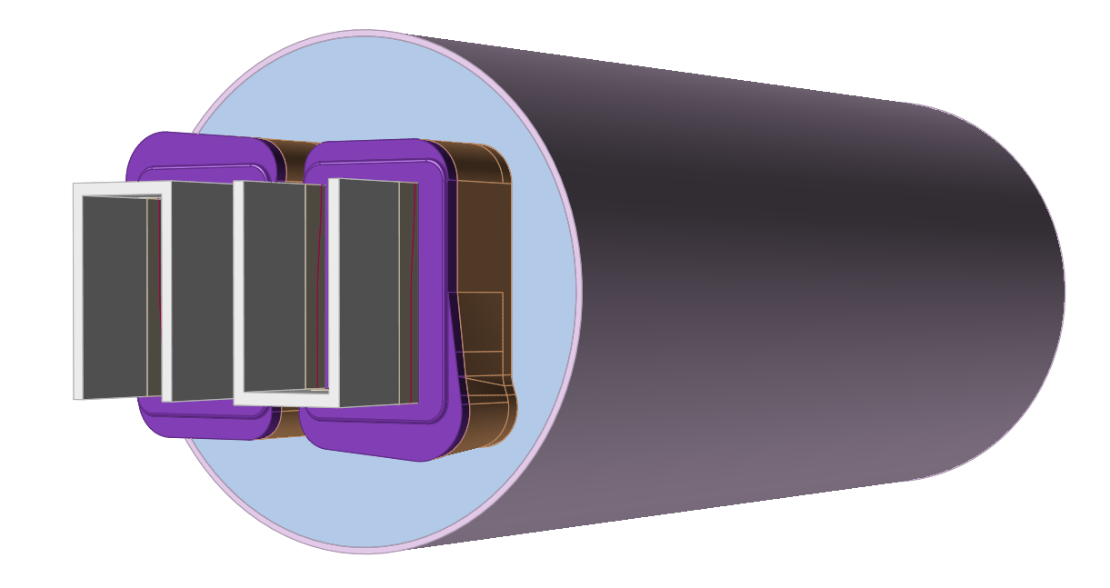

Create the Billet
We will specify the geometry to create the billet.
Click the Create Billet icon.
In the small window that pops up, specify billet and container dimensions ,
select Skin Thickness, and click
Enter.
Note: The billet skin is needed to perform billet skin tracking analysis which is used for determining backend defects. Specifying Skin Thickness creates the billet skin solid. - Press Esc to exit this panel.

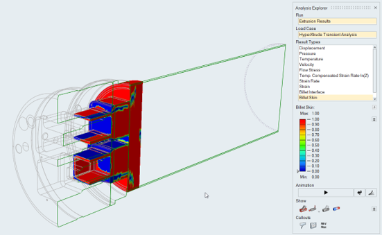

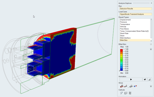

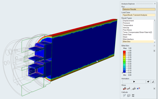

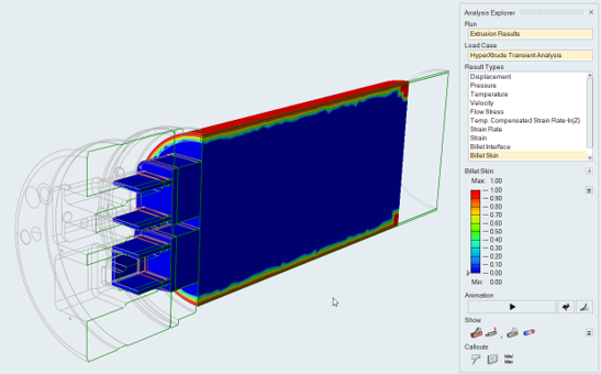

During Ram acceleration time, no billet skin material is present on the exit surface. As extrusion progresses, the billet skin material on the exit surface increases. After 49 seconds of extrusion (the 23rd time step), the exit surface contains more than 5% billet skin.Note: Assumed cutoff value is 5%. Profile with more than 5% billet skin is considered scrap.
