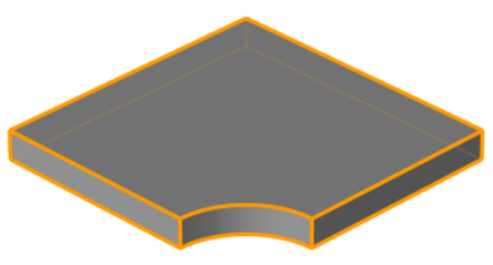

When used on a solid part, the Thicken tool yields a hollow solid:

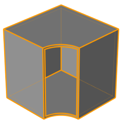

When used on a surface part, the Thicken tool yields a solid part:
