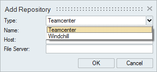

Add a Repository
Add a repository to manage files on your PDM system.
First, you'll need to:
- Integrate Inspire Extrude with your PDM system.
- Obtain the Name, Host, and File Server for the repository, which can be provided by your network administrator

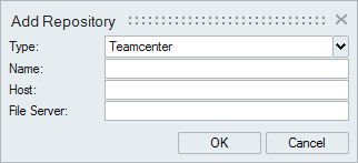

Select .
Add a repository.
For Type, select Teamcenter or Windchill.
- Enter the Name, Host, and File Server.
- Click OK.

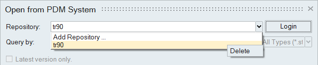

Delete a Repository
Delete a repository when you no longer need it.
Select .
- Click the Repository field.
Right-click the name of the repository, and then click
Delete.

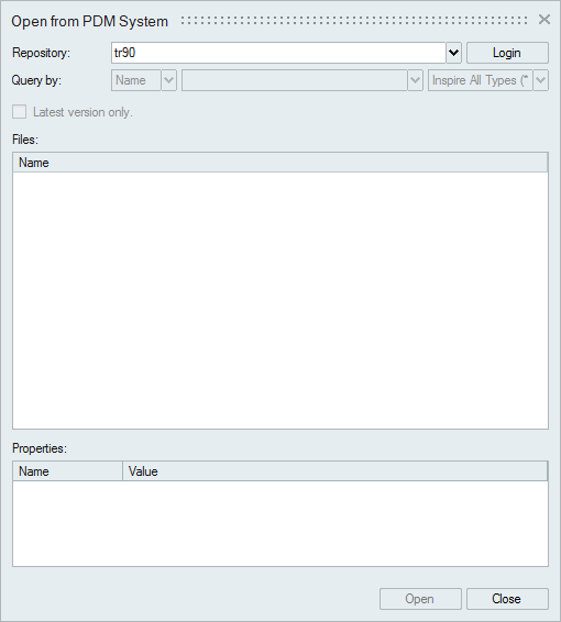

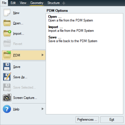

Open a File from Your PDM system
Open a model from your PDM system, or import a saved model from the PDM system and merge it with the current model.
- Add a repository.
- Log in to your PDM system.
Choose from the following options:
Option Description Open a model Select . The current file is cleared from memory.
Import and merge a saved model with the current model Select .
Select a repository.
- Click Login and enter your credentials to log in to your PDM system. If you're unsure what your credentials are, check with your network administrator.

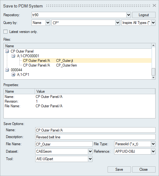

Save a File to Your PDM System
Save a file to your PDM system.
- Add a repository.
Select .
- If you are not already logged in, click Login and enter your credentials to log in to your PDM system. If you're unsure what your credentials are, check with your network administrator.
Perform a query to locate where you want to save the file.
- Teamcenter: Enter a file Name or
ID and press Enter. You
can also filter the results by file type. Select Latest version
only to display only the latest version of a file in the
list of results.
- Windchill: Enter a Part or document, file
Name, or ID and press
Enter. You can also filter the results by file type.
list of results.
The results of the search query are displayed under
Files. Click the + on an assembly node to expand it.
Properties are defined in your PDM system and are for display only.
Select where to save the file.
- To save over an existing file, select the file. If the selected file name already exists in the PDM system, the version in the PDM system will be overwritten.
- To save a file with a new name, select the parent node where you want to save the file. The saved file will appear as a child under the parent.
- Under Save Options, enter a Name and Description for the file. The File Name defaults to the name of the file in Inspire.
- Select a File Type. Dataset, Reference, and Tool are filled in automatically based on the file type. (Teamcenter only; Windchill does not have the Dataset options.) You may need to change these values depending on the requirements of your PDM system.
- Click Save.
