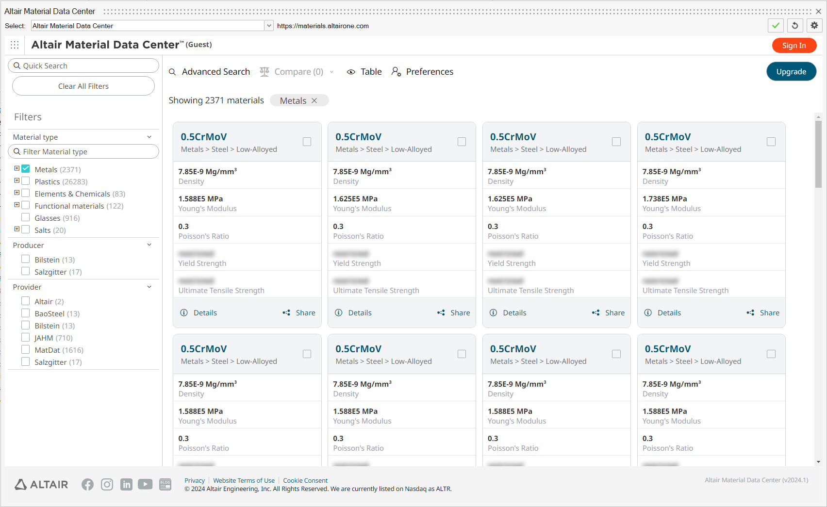

Basic access to AMDC is free. As a Guest user, open https://materials.altairone.com in a browser and view all available materials and names of material producers to explore the database. Create an Altair One account for free to unlock more information & use the advanced search tool.

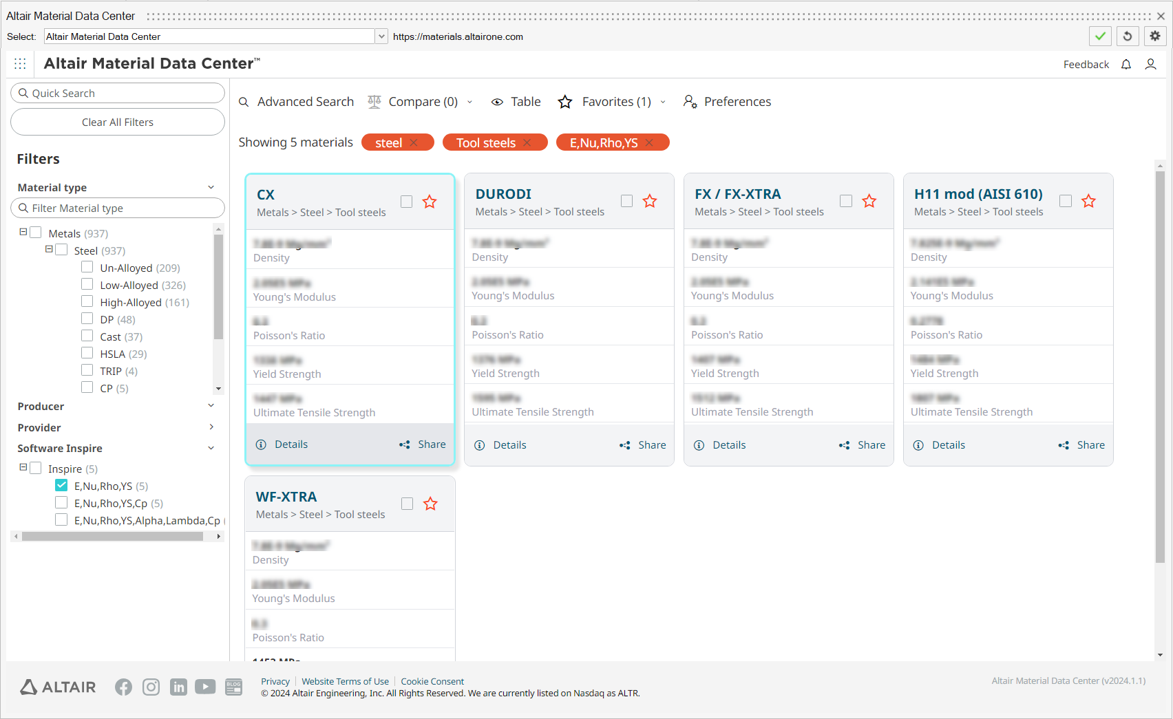

Use the AMDC application to search for materials or a list of materials using quick search, advanced search, or scatter plots.
- Use a Quick Search to search for a material using a string value. For more information, please refer to the AMDC Quick Search help topic.
- Use an Advanced Search to build a search by combining multiple search criteria. For more information, please refer to the AMDC Advanced Search help topic.
- Use a Scatter Plot to visualize the correlation and interdependency between two properties. For more information, please refer to the AMDC View Scatter Plot help topic.
- Use filters to filter search results using predefined categories. For more information, please refer to the AMDC Filter Materials help topic.
Category Description E, Nu, Rho, YS Select for OptiStruct and SimSolid without specific heat (CP). E, Nu, RHO, YS, CP Select for OptiStruct and SimSolid with specific heat (CP).
E, Nu, Rho, YS, Alpha, Lambda, CP Select for Inspire Fluids.

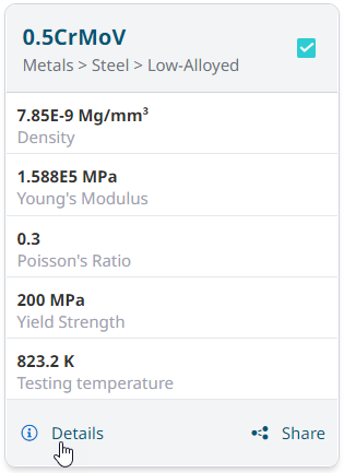

Click Details on the material.

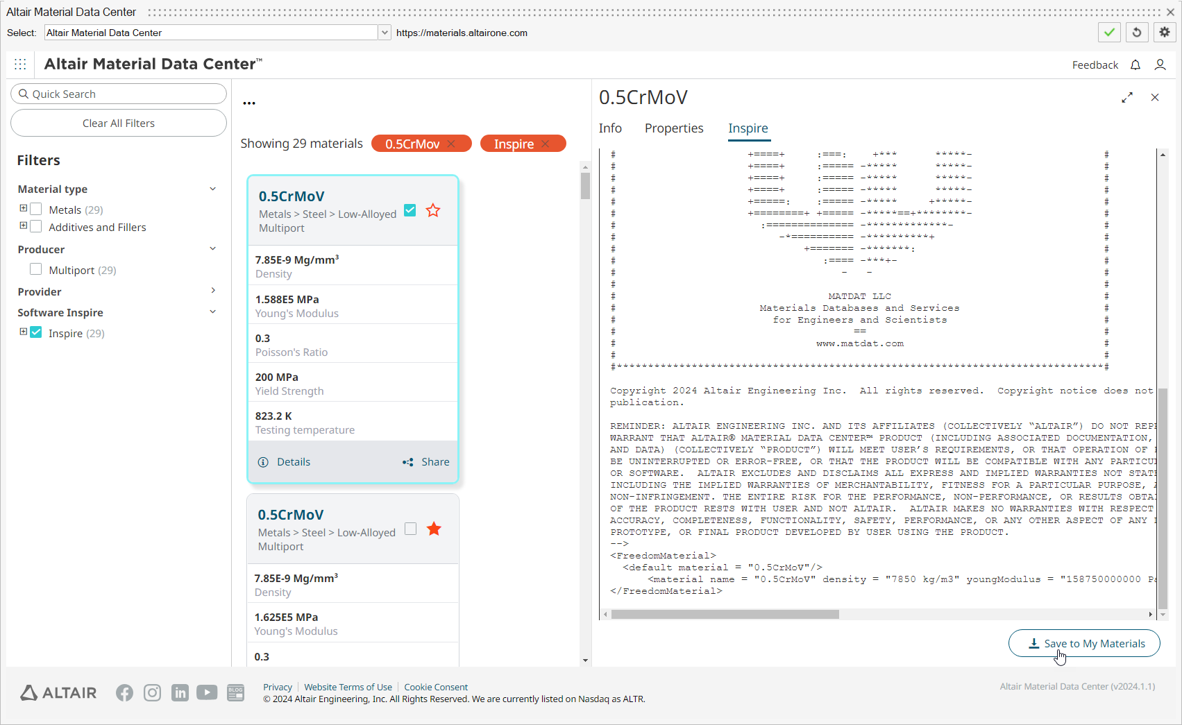

- Click the Inspire tab at the top of the Details pane.
Click Save to My Materials in the lower-right corner of
the Details pane.

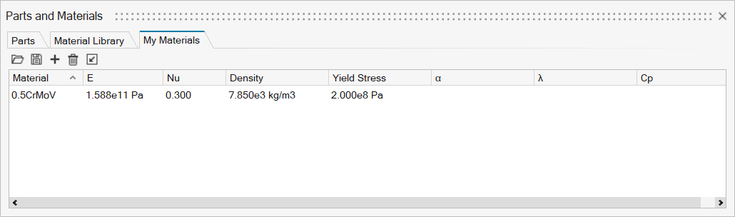

After the download is complete, the material is available on the My Materials tab in the Parts and Materials guide pane.
