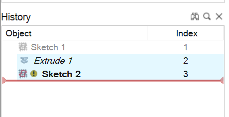

When there's a dimension or a sketch relation between a sketch entity and a reference
edge/vertex and, for any reason, an upstream geometry change triggers a downstream
compute that removes the reference edge/vertex, these missing references are shown
as orphans inside the sketch. A sketch with orphans will be indicated by a warning
icon in the construction history browser.

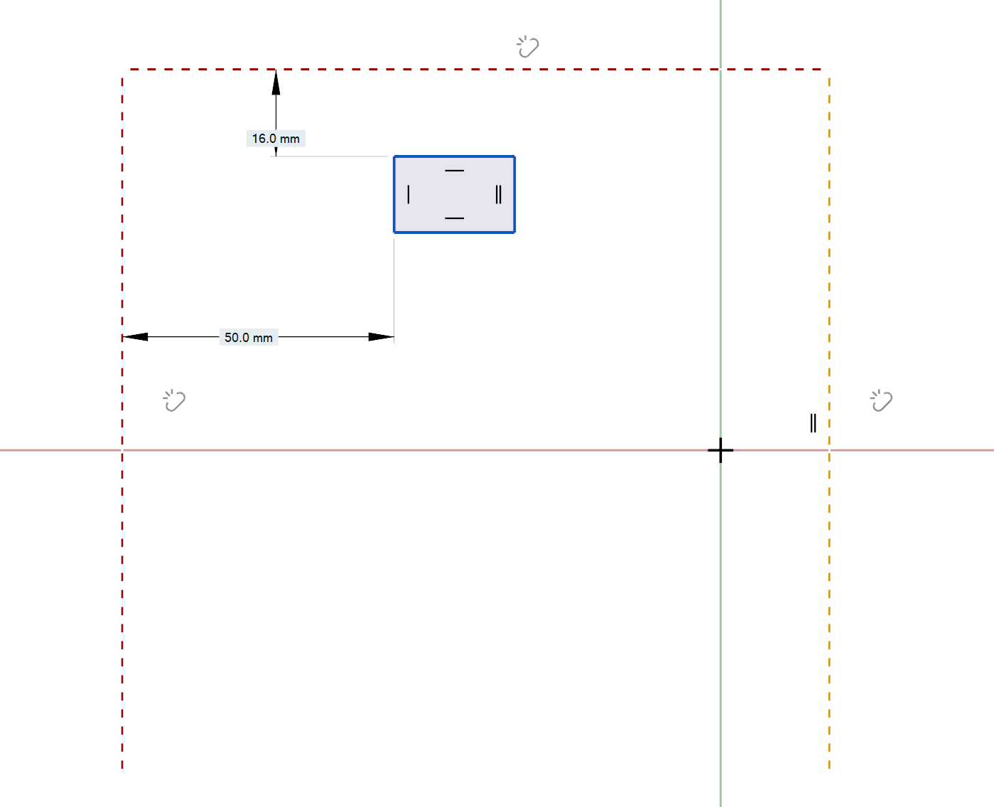

To fix the missing references inside the sketch, double-click it to enter edit mode. You will see an orphan
icon and a tooltip, indicating an orphaned item.
