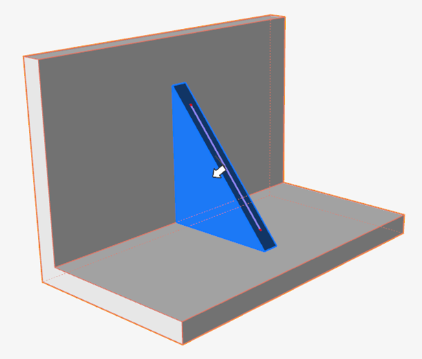

Extrude rib geometry from a sketch to stiffen your model. You can select an arc, curve, straight line, or curved surface.
First, create a target part and a sketch.
On the Geometry ribbon, select the
Rib tool.
Select a sketch.
Note: The sketch should not extend beyond the part. The Rib tool currently does not support sketch profiles when they extend beyond the boundaries of the part or penetrate the walls of the part.
Select a target part.
The rib is automatically extended past the nearest face on the solid.Warning: Sometimes, the rib may not be extended as expected. In this case, create the desired sketch, without the need for automatic extension, and then repeat the previous steps to create the rib using the desired sketch.
