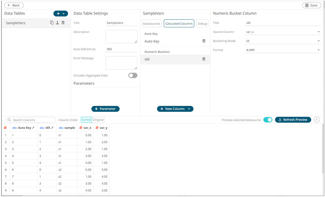

- Create a Numeric Bucket column of type "Id" (unique values), based on the X-variable column

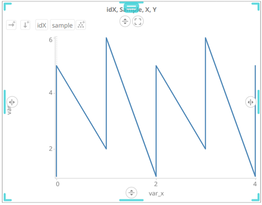

Sample 1. Only the sample column is added on the Items list

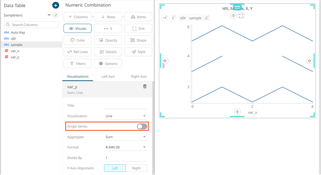

- Switch off Single Series for the Y-axis variable

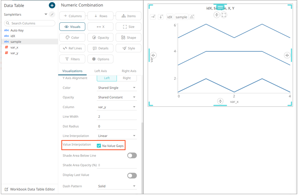

With the above settings in place, you will get separate lines per each sample identity. You will then also be able to color those line by the sample identity. If your dataset has missing values, for one or several of the samples/series, you can bridge those value gaps by switching on interpolation of NA value gaps on the Y-variable.
Sample 3. Single series on Y is turned OFF
Sample 4. Interpolation of NA value gaps on Y is turned ON.

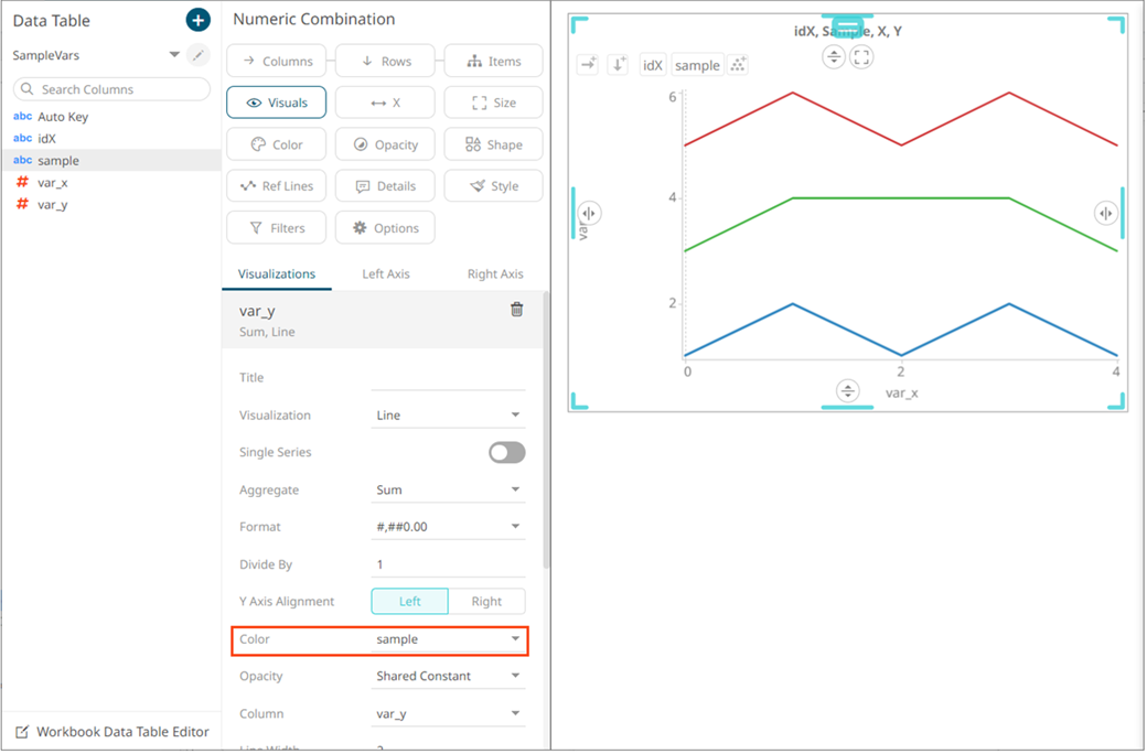

Sample 5. Color line by the sample column
