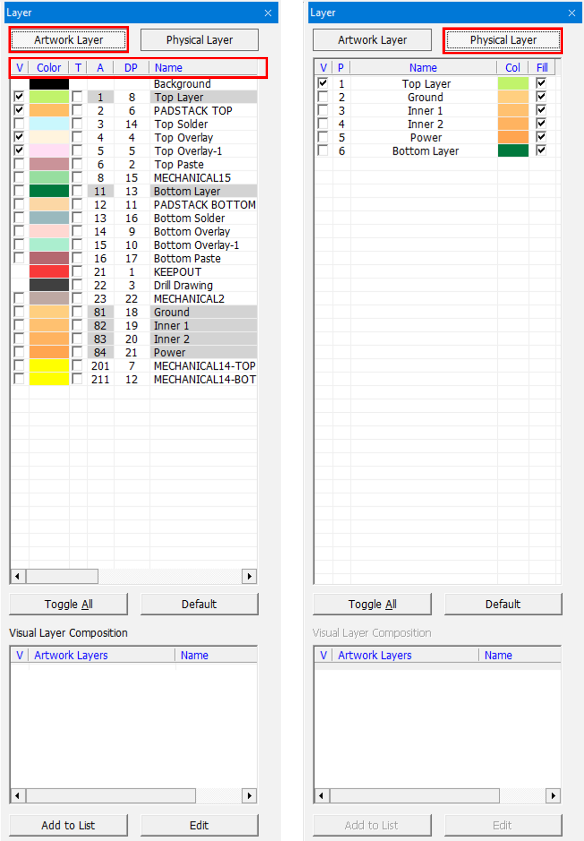

To control or set the layer status, click from the menu bar. Shortcut key: Alt + L. The Layer dialog opens.
- Artwork Layer: Select this button to show layer orders with artwork layers.
- Physical Layer: Select this button to show layer orders with physical layers.
- Each column’s abbreviation means properties of layers.
- V: Make visible On/Off for layer.
- T: Make transparent layer status.
- A: PollEx PCB’s artwork layer number.
- DP: Display Priority for showing layer. Lower number layer will be displayed at top.
- Name: Layer name.
- With layer control window, user can do work for selecting layer, making layer status visible/invisible.
- E: ECAD artwork layer number.
- P: Physical layer number.
- Type: Physical layers’ type.
- Attr: Layer attributes. Values will be one of positive or negative.
- At layer type selection, select one between artwork and physical layer.
- Among layer list, select one of layers.
- Launch Layer window for detail set-up for layer status.
- Visual Layer Composition: You can layer pairs to be displayed at same
time.
- Select the layers to be included in a specific layer composition in the Artwork Layer List.
- Click Add to List to enter the name of the layer composition.
- Click OK to create a new layer composition item and display it in the Visual Layer Composition window.
- Click Edit to modify the layer composition.
