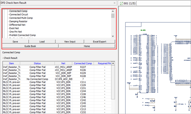

You can confirm the results when the selected test is completed.
The result file has an extension of SDFER, and it is possible to view only the result
afterwards. In other words, the result can be sent to another person who requests
only the result data, and the identical result can be viewed by that person as
well.
The initial result window is as follows.
Navigation Tree: This
section shows the test categories. It is shown in a tree-structure to make it
convenient for checking each category.
Save: This button allows the
result data to be saved.
Load: This button is for
loading the result data (.SDFER). The saved result data can be
sent to others separately to enable sharing of the result.
View Input: Change a mode to
DFE Input Setup dialog.
Excel Export: This button
allows the result data to be saved in an Excel file format. User defined format
allows the user to define each category as he needs and save it in excel file.
Further details are shown as follows.
Guide Book: Upon clicking
this button, the document registered from the Environment-Reference File Link
menu is opened.
