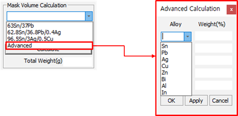

For the wave soldering, solder mask area is calculated to estimating the lead amount. By using the solder mask information of the PCB design data, you can easily calculate the area on the Solder Quantity Calculator. For the reflow soldering, the lead amount can be calculated according to the area of the metal mask, the thickness of the metal mask, and the material of the solder cream.

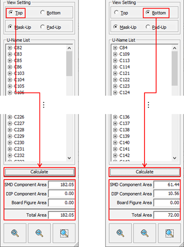

- From the menu bar, click .
In the View Setting section, select Top or
Bottom and click Calculate to
calculate the Solder Mask area.
Figure 1. -

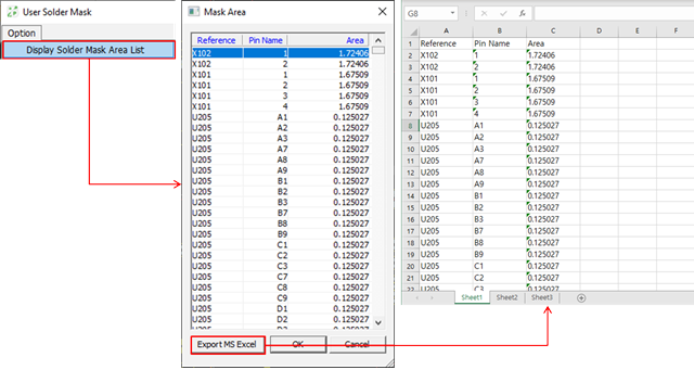

Check the Solder Mask area per each component pin.

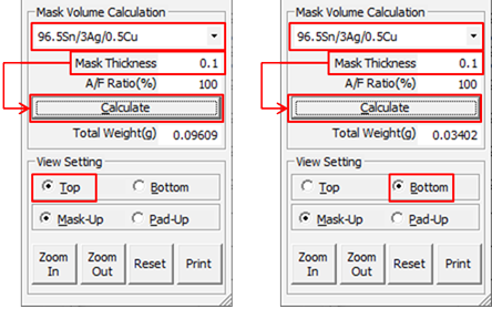

- From the menu bar, click to run Metal Mask.
Calculate the Metal Mask Area.
Figure 3. -

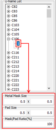

Select a component pin to check the pad size and metal mask size.

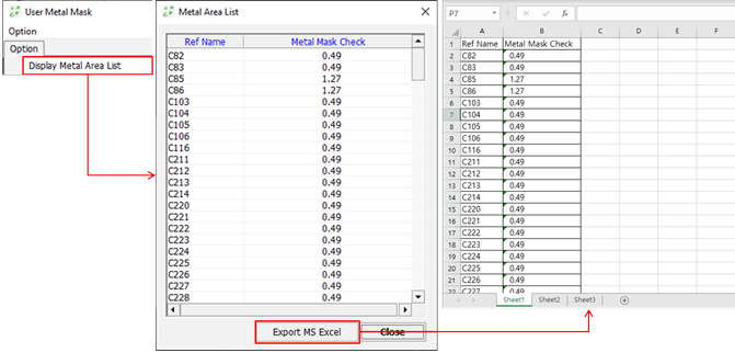

Figure 5. -
Check the Metal Mask area per a component.
