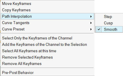

Context Menu Options
Right-click a key frame or the timeline itself to display a context menu with additional options.
Option Description
Move Keyframes Specify absolute time.
Copy Keyframes Copy the selected key frames.
Path Interpolation This option defines how the interpolation is done from one key frame to the next. For the last frame, this option is disabled.
For example, for the Position channel, using Linear means that the position is interpolated linearly (straight line) and using Smooth for means that the position is interpolated smoothing (curved smooth line).
On the other hand, for Step, let's say there are two key frames, A and B. The object doesn't move between A and B like it does for linear and smooth types of interpolation. The object will disappear from A and appear at B.
  • Step
  • Cusp
  • Smooth
Curve Tangents This option defines tangency between selected key frames.
  • Free
  • Smooth
Curve Preset This option defines the curve between selected key frames. Note, when the Curve Preset is set to Smooth, the Curve Tangent option is automatically set to Free.
  • Linear
  • Smooth
Select Only the Keyframes of the Channel Select only the key frames in the selected channel.
Add the Keyframes of the Channel to the Selection Add key frames from another channel to the key frame selection.
Select All Keyframes at This Time Select all keyframes at the current time.
Remove Selected Keyframes Remove only the selected key frames from the timeline.
Remove All Keyframes Remove all of the key frames from the timeline.
