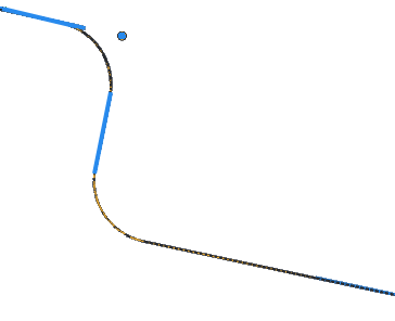

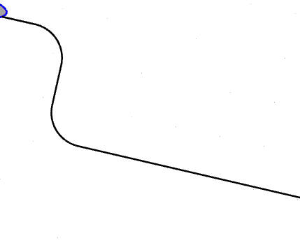

  7. Select a rib type:
    • Start with Arc: The rib extends from the part with an arc, ensuring tangent continuity, and drops down to the binder with a smooth fillet between them.
      The rib is parametric. To edit the dimensions, select the respective handles.
    • Line with Arc: The rib extends from the part with a line, ensuring tangent continuity, and then follows with an arc and flat before dropping down to the binder with a smooth fillet between them.

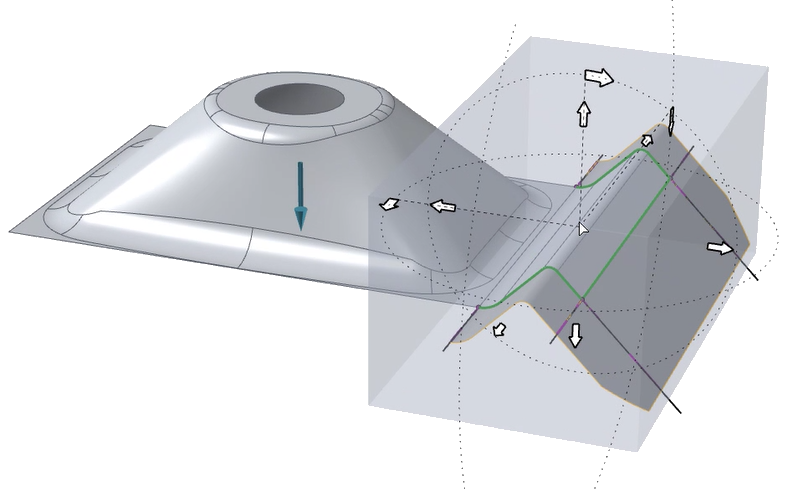

  8. Create the ribs and the surfaces that extend from the part to the binder:
    • To automatically create ribs at standard locations (sharp corners where edge continuity is broken), right-click. To add ribs at custom locations, see the next step.
  9. The rectangular box shows the size of the extended part.
    • You can adjust the size and orientation of the box by using the graphical manipulator on the box face.
  10. Adjust the extension surface:
    Note: In the modeling window, the extended surface intersection with the box is indicated by a green line. A discontinuity in the green line indicates the surface has not been extended sufficiently and should be fixed.
