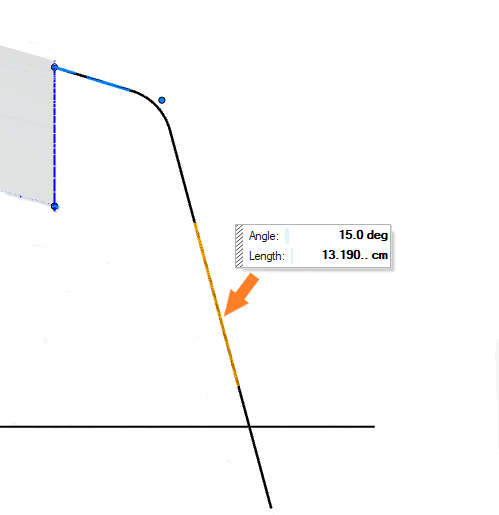

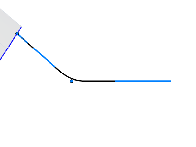

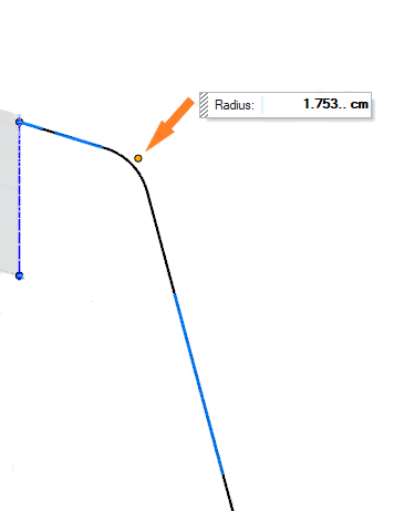

  6. Select a rib type:

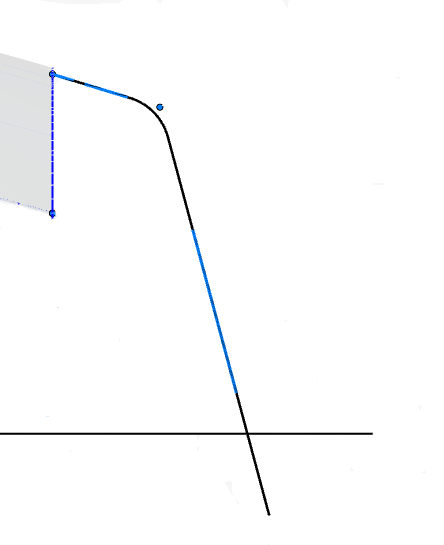

    • Start with Line (default): The rib extends from the part with a line with tangent continuity and drops down to the binder with a smooth fillet between them.
      The rib is parametric. To edit the dimensions, select the respective handles.

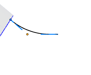

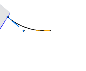

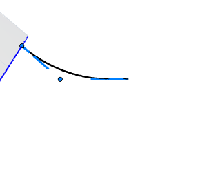

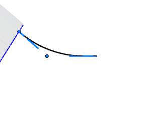

    • Start with Arc: The rib extends from the part with an arc, ensuring tangent continuity, and drops down to the binder with a smooth fillet between them.

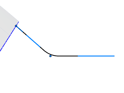

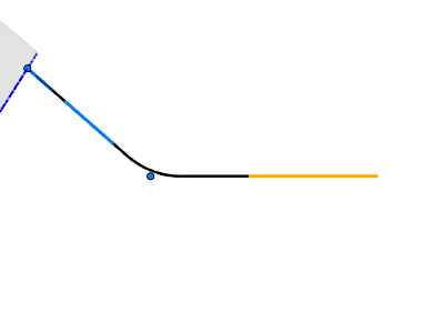

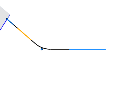

    • Line with Arc: The rib extends from the part with a line, ensuring tangent continuity, and then follows with an arc and flat before dropping down to the binder with a smooth fillet between them.

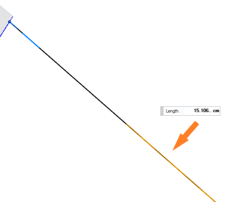

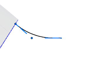

    • Straight Line: The rib extends from the part with a line, ensuring tangent continuity, and is continuous down to the binder.
      Tip: You can align Straight Line ribs with an existing edge using the Reference Edge option detailed below.

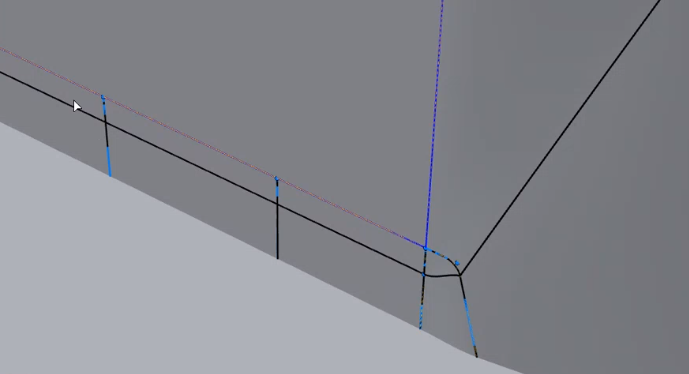

  7. Create the ribs and the surfaces that extend from the part:
    • To automatically create ribs at standard locations (sharp corners where edge continuity is broken), right-click. To add ribs at custom locations, see the next step.
  8. Adjust the flange loft:
    To Do this Note
    Edit the ribs In the guide bar, select Edit Ribs. You can add, delete, and adjust ribs.
    • To add ribs at custom locations, first hold down Alt while hovering over an addendum start edge, and then click a blue or green dot. A green dot indicates a sharp corner where edge continuity is broken.
    • To delete a rib, select it and press Delete.
    • To adjust a rib, select it and configure the options in the microdialog or Control Panel. See Rib Options.

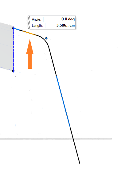

    Interactively edit rails By default, rails are created automatically (Auto create rails is selected in the Control Panel).
    1. In the guide bar, select Interactively edit rails.
    2. Do one of the following:

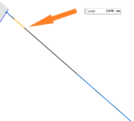

      • Hover over the rail to display handles. You can do the following:
        • Drag the upper arrow to change the length of the addendum extension from the part.
        • Drag the lower arrow to change the angle of the rib plane.
      • Select a handle and enter an Angle or Length in the microdialog.

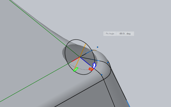

    Translate or rotate the rib plane If none of the options to automatically align the ribs produces the desired result, use the graphic manipulator to reposition the rib plane.
    1. In the guide bar, select Edit Ribs.
    2. Click and drag one of the red, green, or blue arrows to rotate the rib plane around the corresponding colored axis. The angle measures the rib angle with respect to the corresponding axis.

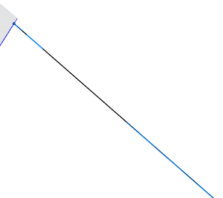

    Align Straight Line ribs with an existing edge
    1. Do one of the following:
      • Select the Straight Line ribs you want to align.
      • Select the desired rib and, in the guide bar, change the rib type to Straight Line.
    2. In the guide bar, select Reference Edge.
    3. Select the reference edge. Tangency is maintained between the straight line ribs and the reference edge, so if the straight line edge is next to the reference edge, they become one continuous edge.
      Figure 1. The Straight Line edge (black and lighter blue) and the Reference Edge (cobalt blue) are now like one continuous edge
