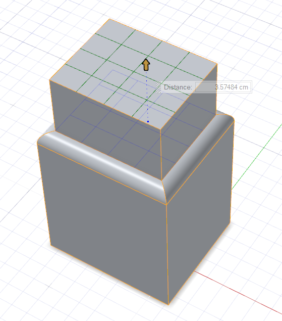

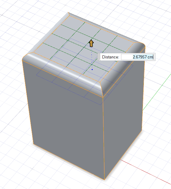

      • In some cases, such as a round, push/pulling a face moves the adjacent faces too. To move a single face in a group such as a round, in the guide bar select Step , and then drag the arrow.
        Figure 1. Without Step selected, push/pulling the face moves the group of faces
        Figure 2. With Step selected, push/pulling the face only moves the single face

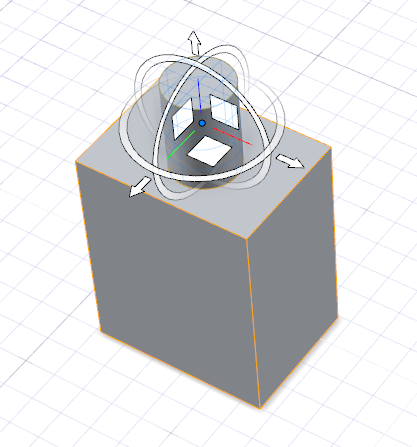

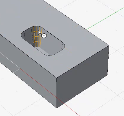

    Translate and rotate a feature A feature is a set of faces such as a hole, pocket, or protrusion.
    1. In the guide bar, select Operation: Move Feature.
    2. Select a face of the feature that is along the boundary edge.

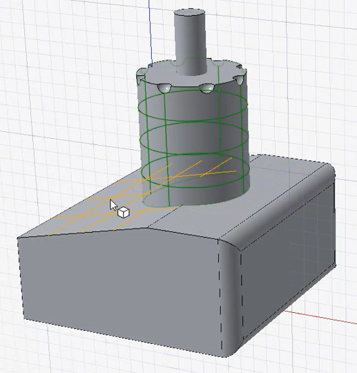

      Note: The feature can intersect only one face of the object.
      Figure 3. This cylindrical protrusion is an example of a feature that doesn't work with the Move Feature tool because it intersects more than one face of the object
    3. The Move tool opens automatically. Use the Move tool to rotate and translate the feature.
