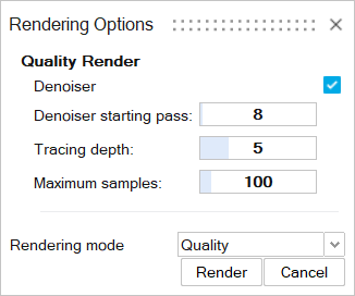

The Rendering Options dialog box is displayed.
Edit the parameters:

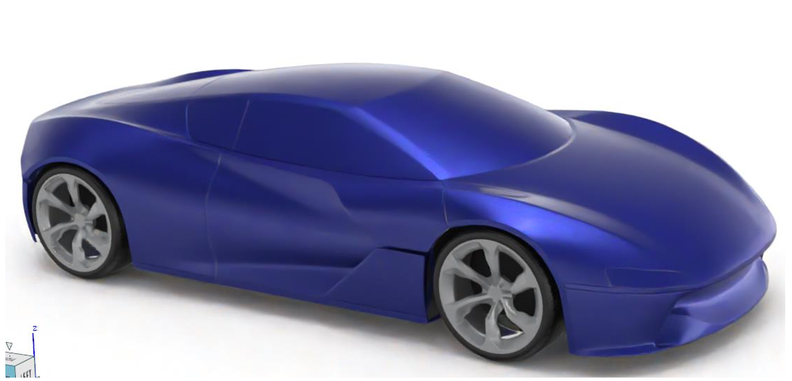

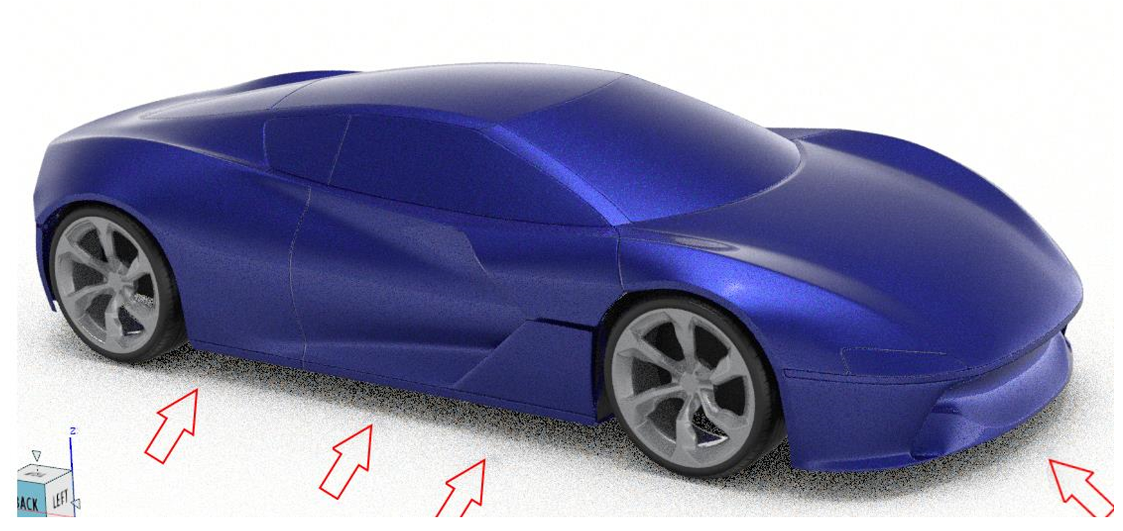

Name Function Denoiser Reduce the amount of noise/grains in the final rendered image. There are noise/grains around the bottom of the car, as indicated by the red arrows. After applying a denoiser, noise/grains have been removed. Denoiser starting pass Define the number of passes after which the denoiser should start working. Tracing depth Define the maximum number of bounces a ray will have (diffuse, reflection, etc.).
Increase the value for a more accurate visualization, or decrease it to reduce rendering time.
Maximum samples Control the maximum number of times each pixel will be calculated and refined for further accuracy. Each additional sample smooths out noise/grain one step further. Use higher values for a smoother, cleaner rendering. Denoiser shared memory (AMD) Enables the denoiser to use shared memory in the GPU in order to share data with the application. This option improves performance because it avoids transferring data in CPU memory.

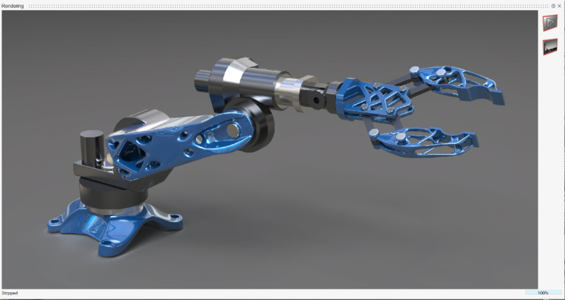

The Rendering window is displayed. The progress is displayed at the bottom left. To start, pause, or resume rendering, click Start/Pause/Resume rendering
at the top right.
