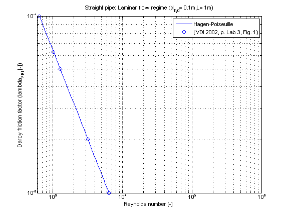

Verification
The Darcy friction factor lambda_FRI in dependence of Reynolds number is shown in the figure below.
laminar

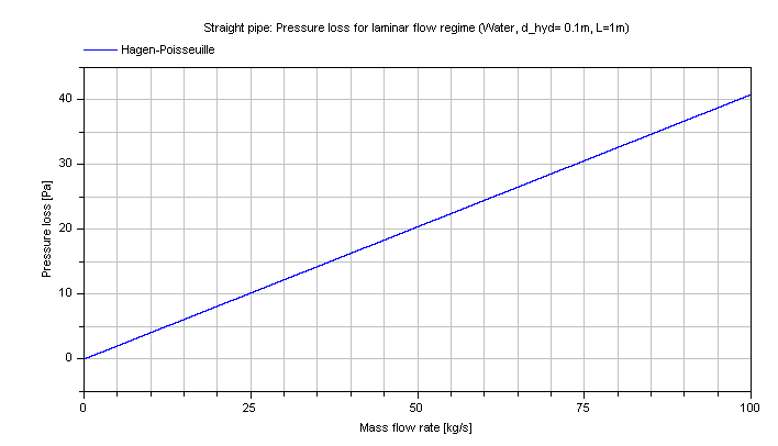

The pressure loss dp for the laminar regime in dependence of the mass flow rate of water is shown in the figure below.
dp_laminar

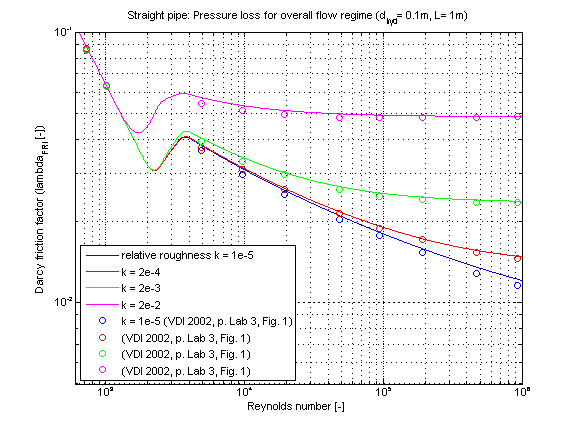

Verification
The Darcy friction factor lambda_FRI in dependence of Reynolds number for different values of relative roughness k is shown in the figure below.
dp_overall_1

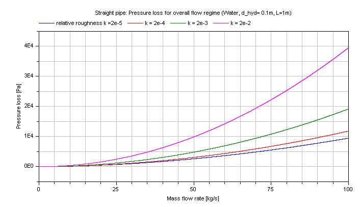

The pressure loss dp for the turbulent regime in dependence of the mass flow rate of water is shown in the figure below.
dp_overall_2

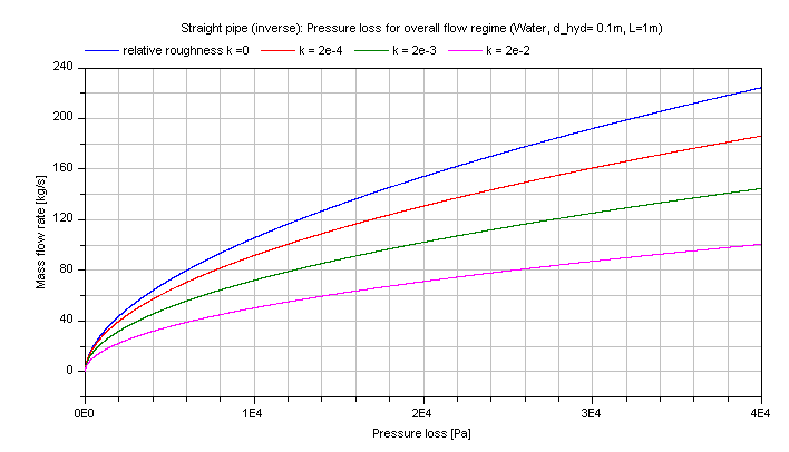

And the mass flow rate m_flow for the turbulent regime in dependence of the pressure loss of water is shown in the figure below.
dp_overall_3

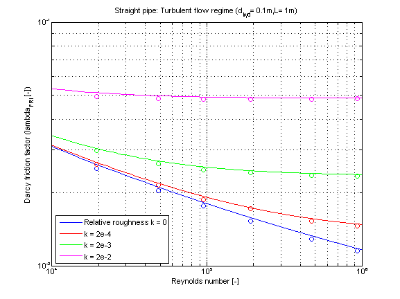

Verification
turbulent

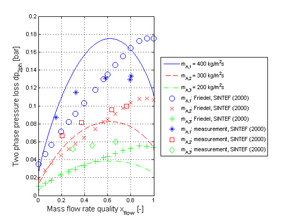

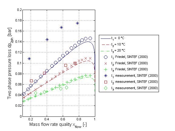

Verification
The two phase pressure loss for a horizontal pipe calculated by the correlation of Friedel neglecting momentum and geodetic pressure loss is shown in the figure below.
dp_twoPhaseOverall_1
The two phase pressure loss for a horizontal pipe calculated by the correlation of Chisholm neglecting momentum and geodetic pressure loss is shown in the figure below.
dp_twoPhaseOverall_4
