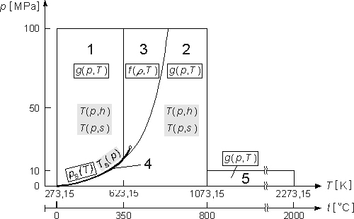

1. Structure and Regions of IAPWS-IF97
The IAPWS Industrial Formulation 1997 consists of a set of equations for different regions which cover the following range of validity:
273,15 K < T < 1073,15 K p < 100 MPa
1073,15 K < T < 2273,15 K p < 10 MPa
Figure 1 shows the 5 regions into which the entire range of validity of IAPWS-IF97 is divided. The boundaries of the regions can be directly taken from Fig. 1 except for the boundary between regions 2 and 3; this boundary, which corresponds approximately to the isentropic line s = 5.047 kJ kg -1K-1, is defined by a corresponding auxiliary equation. Both regions 1 and 2 are individually covered by a fundamental equation for the specific Gibbs free energy g( p,T ), region 3 by a fundamental equation for the specific Helmholtz free energy f ( r,T ), and the saturation curve, corresponding to region 4, by a saturation-pressure equation ps( T ). The high-temperature region 5 is also covered by a g( p,T ) equation. These 5 equations, shown in rectangular boxes in Fig. 1, form the so-called basic equations.
Figure 1: Regions and equations of IAPWS-IF97
In addition to these basic equations, so-called backward equations are provided for regions 1, 2, and 4 in form of T( p,h ) and T( p,s ) for regions 1 and 2, and Ts( p ) for region 4. These backward equations, marked in grey in Fig. 1, were developed in such a way that they are numerically very consistent with the corresponding basic equation. Thus, properties as functions of  p,h and of  p,s for regions 1 and 2, and of p for region 4 can be calculated without any iteration. As a result of this special concept for the development of the new industrial standard IAPWS-IF97, the most important properties can be calculated extremely quickly. All Modelica functions are optimized with regard to short computing times.
The complete description of the individual equations of the new industrial formulation IAPWS-IF97 is given in IF97.pdf. Comprehensive information on IAPWS-IF97 (requirements, concept, accuracy, consistency along region boundaries, and the increase of computing speed in comparison with IFC-67, etc.) can be taken from IF97.pdf or [2].
