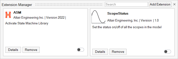

Add and Install the Extension

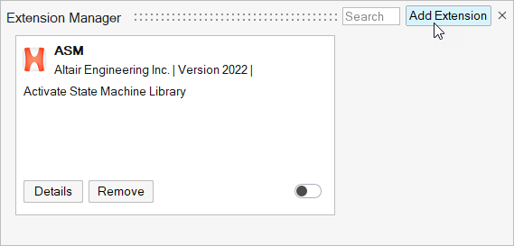

- Select .
Select the Add Extension button.
Select the folder where the extension is saved:
<installation_directory>/tutorials/ScopeStatus.
The extension is added to the Extension Manager.

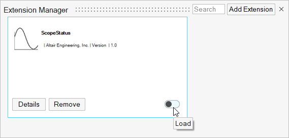

After adding an extension to the Extension Manager, you must install it to enable its use.
Select the Load button on the extension and slide
right.
The extension is now installed and is accessible from the ribbon:

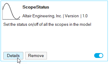

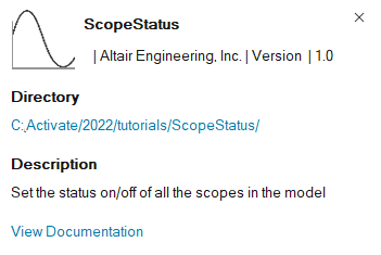

Inspect the Extension Details
Click the Details button on the ScopeStatus
extension.
Review the information such as the author and version.

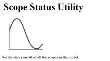

Select the View Documentation link and review the
information that is available in the extension folder.

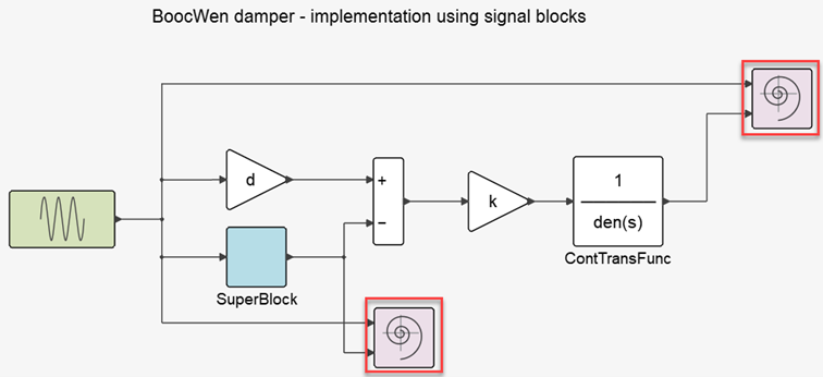

Apply the Extension to a Model

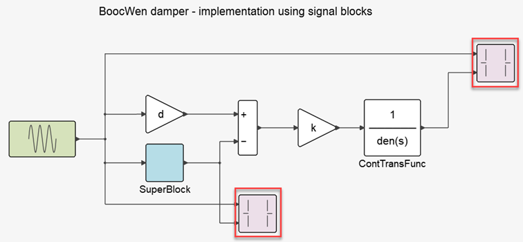

- Open a model that includes scope blocks, for example: .
On the ScopeStatus ribbon, click the Off icon.
Verify that the status of the scopes is Off.
Click the On icon.
Verify that the status of the scopes is On.
You've successfully applied the ScopeStatus extension to your model!
