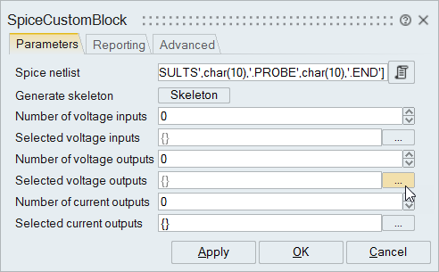

- From the , drag one SpiceCustomBlock into your diagram and double-click it.
From the Parameters tab, select the SPICE Netlist button.

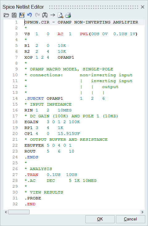

The Spice Netlist Editor appears. -
Copy the code from the opnon.cir file and paste it into
the Spice Netlist Editor.
- Click OK.

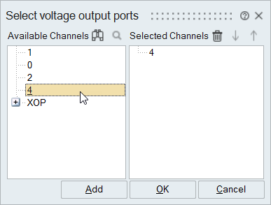

From the Parameters tab, select the button to define the Selected
voltage outputs.
The Select voltage output ports dialog appears. -
From the list of Available Channels, double-click
4.
Click OK.

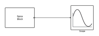

- From the Palette Browser, select .
Drag one Scope block into your diagram and connect it to
the output of the SpiceCustomBlock.
This portion of the model is ready to run and test. -
From the Run
tool, select Setup
- Select the Simulation Time tab.
- For Final Time, enter 10e-5 seconds.
Click Run
Double-click the Scope block in the model. The plot should look something like this:

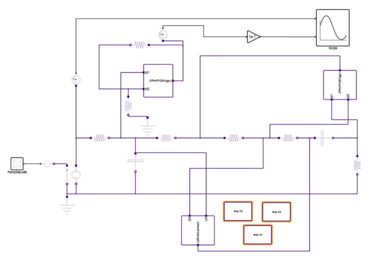

Create a Spice Model from a Modelica Model
Create a circuit with components from the HyperSpice palette. Base your model on the Modelica example that is provided.
From the Demo Browser, select BandPassFilter.scm
The BPF model constructed from Modelica blocks appears.
Beginning with the Filter.scm model you started, construct
a Spice version of the circuit model using the blocks from the HyperSpice
palette.
To create these components in your model Include these blocks from the Spice palette Voltage and current stimulus Voltage Constant; Voltage Pulse; Voltage SIN Linear components Resistor; Capacitor; Inductor Voltage and current constant sources Include blocks as required for your model. Semiconductor components Diode; BJTNPN; BJTPNP; Mos1N; Mos1P; Mos2P; Mos2N; Mos3N; Mos3P Sub circuits Include blocks as required for your model. Cable or S-parameter functions Include blocks as required for your model. Refer to the Extended Definitions to define the blocks.

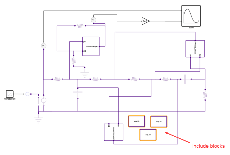

From the , drag one include block into the current
diagram, then double-click the block.
The include block must reside in the diagram, but does not require a connection to the blocks in the diagram.
- For File name to include, enter: aop.lib. Keep the defaults for any remaining parameters.
Because three operational amplifiers are required for your model, three include
blocks are also required. To duplicate the current include block, select it and
press Ctrl+D two times.
Your final model should look something like this:
