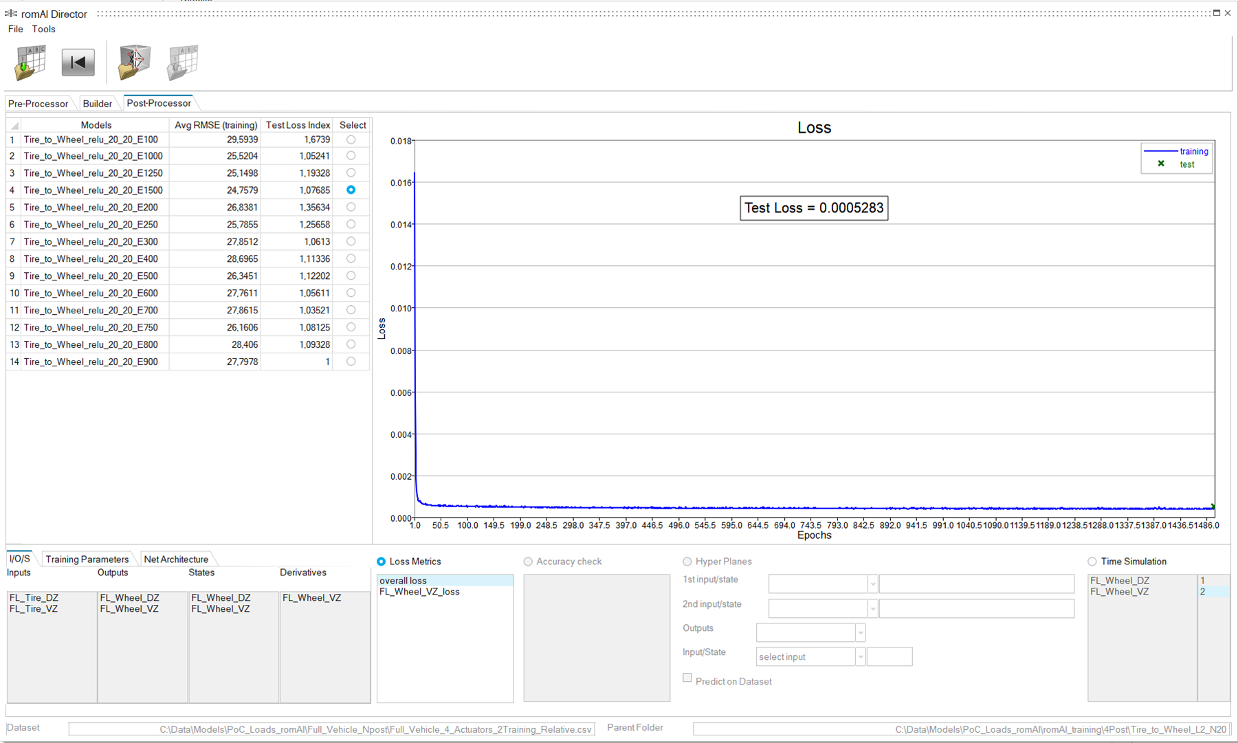

  • Select a previously-trained romAI or a folder that contain romAI models using the icon.
After the romAI folder or a master folder is selected, you can see the romAI model names in the table on the left side.
The Parent Folder shows the path of the selected master folder. All the models inside it are listed in the post-table. Next to the model names, the Avg RMSE (training) along with the Test Loss Index columns also get populated in the table.
The Avg RMSE (training) is calculated as the average of all outputs and segments of the root mean square error between the target vs romAI predictions evaluated on the training set. The model with the least RMSE gets automatically selected.
The Test Loss Index column has a minimum value of 1, which represents the model with lowest value of training loss. The other loss values represent the scaling factor of the loss compared to the minimum loss value.
After the post-processor is populated, you can view the following information in the Info panel in the bottom-left of the Post-Processor tab:
  • I/O/S: Inputs, outputs, states (and physical constraints)
  • Training Parameters
  • Net Architecture parameters

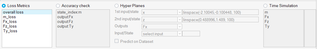

In the bottom-right of the Post-Processor tab, you can choose from among four tools:
  • Loss Metrics
  • Accuracy check
  • Hyper Planes
    Note: This option is available only where it is applicable. It is not available if the total number of inputs and states are less than two.
  • Time Simulation

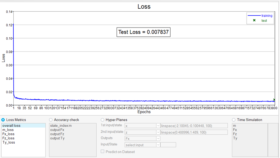

Check Loss
View the overall training, validation, and test loss.
Note: Check Loss is only available if Method has been set to Deep learning as the training method in the Builder tab.

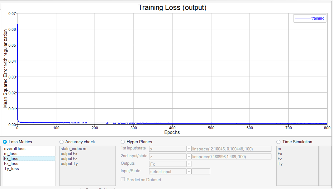

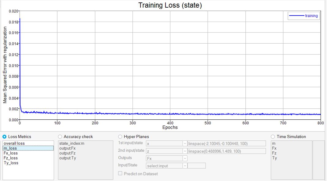

Select the Loss Metrics radio button.
This loss is a constant value that represents the error made by the trained romAI model when predicting over the testing dataset. The data is reported in the text box of the loss chart and refers to the value calculated after the training as shown below:
The data also shows the training/validation loss of each single output or higher-order state variable, such as velocity in this case.
At this point, the typical machine learning considerations are valid, such as:
  • The lower the training error, the more accurate the ROM.
  • If the training and test loss is close to each other, then the training has converged.
  • If the training and test losses diverge, then the ROM might be affected by overfitting. In this case, you may want to consider increasing the regularization term.

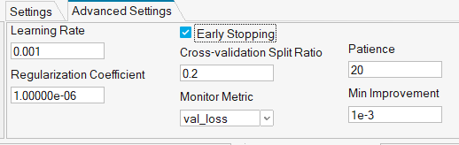

  • The cross-validation ratio is used to monitor the Early Stop criteria. To change the cross-validation ratio, select the Early Stopping check box as shown below.

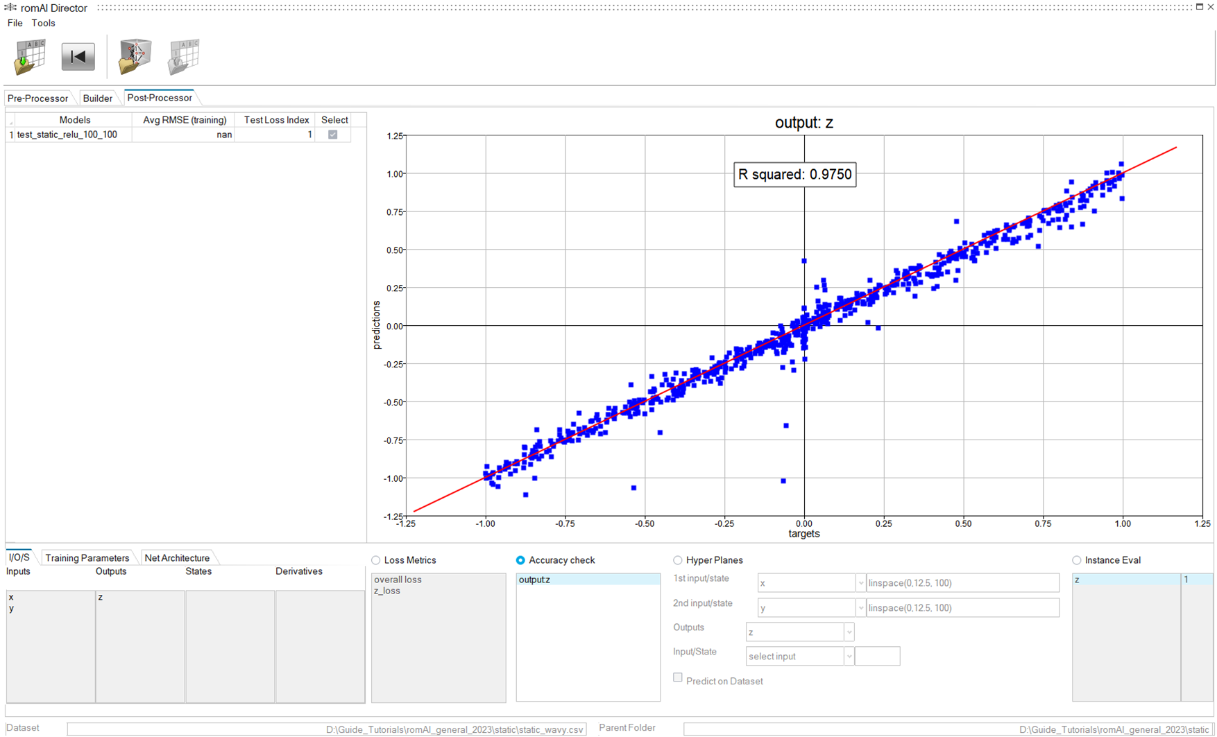

Select the Accuracy check radio button.
Accuracy check requires a test dataset for prediction. If the test dataset is not provided or if it incompatible with the model feature names, then an error dialog box is shown.
The test dataset name is populated in the file name info entries on the bottom of the panel.

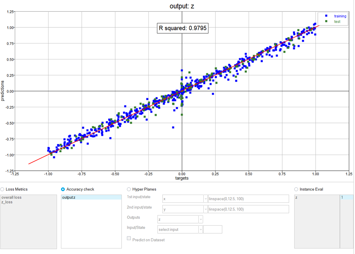

The training dataset is automatically loaded as test dataset in the post-processor just after the training. In this case, the training data points are shown with blue color and test data points are shown with green color.
The y-axis shows the predictions of the selected output produced by the romAI model, given the inputs defined in the dataset file.
The x-axis shows the targets for the same selected output contained in the same dataset file.
The closer that the predictions are to the targets, accordingly, more blue points will be aligned to the y = x curve, drawn in red.
The R2 coefficient gets computed automatically.

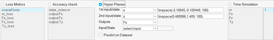

Define Hyper Planes
Note: The Hyper Planes section is only available if Method has been set to Deep learning as the training method in the Builder tab.
Select the Hyper Planes radio button.

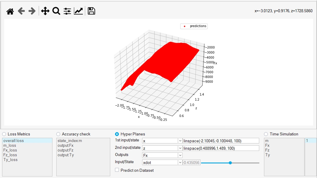

romAI draws two types of 3D plots:
  • Hyper planes: The application evaluates the trained romAI model over a range of user-defined input values and displays the output as a hyper plane. One output at a time can be displayed.
  • Scatter plots of Predictions vs Targets: The application evaluates the trained romAI model into a set of points contained in a dataset file and compares the output results with the target points contained in the same dataset file through a scatter plot. Only one output at a time can be requested.

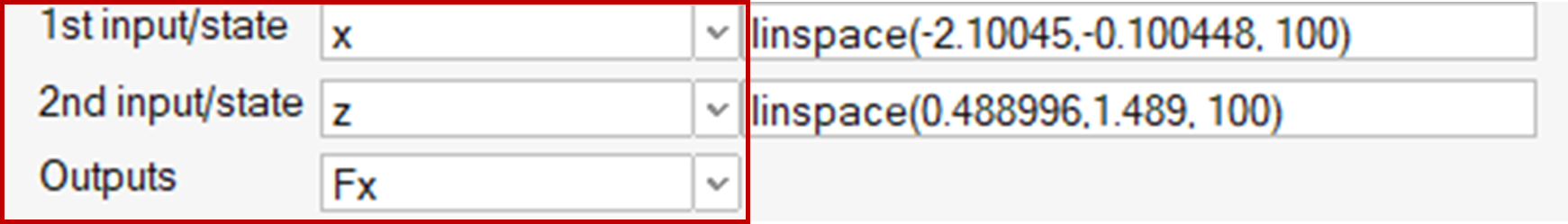

Generate Hyper Planes

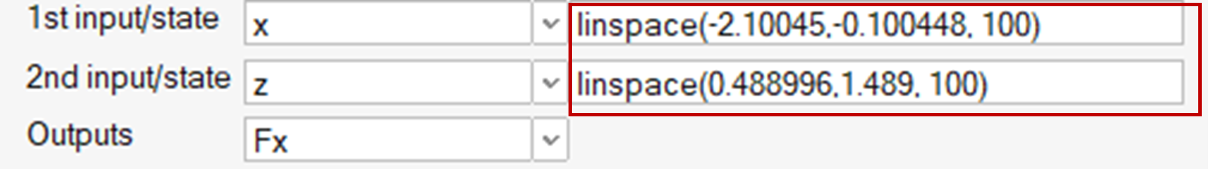

  1. Select the 1st and 2nd inputs from the Inputs/States menu for the x-axis, y-axis, and one output from the Outputs menu for the z-axis.
  2. Specify the range of the x- and y-axes using Compose OML syntax.
    The x/y grid is automatically created for the hyper plane. All other inputs and states are held constant.

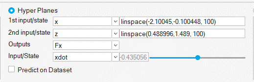

  3. For each additional input and state that you want to include, you can specify the constant value for each through the menu and the slider.
    After you have specified the values for all the inputs and states, the hyper planes are updated automatically.
    The axes are labeled with respect to the names of the selected inputs and states and output.

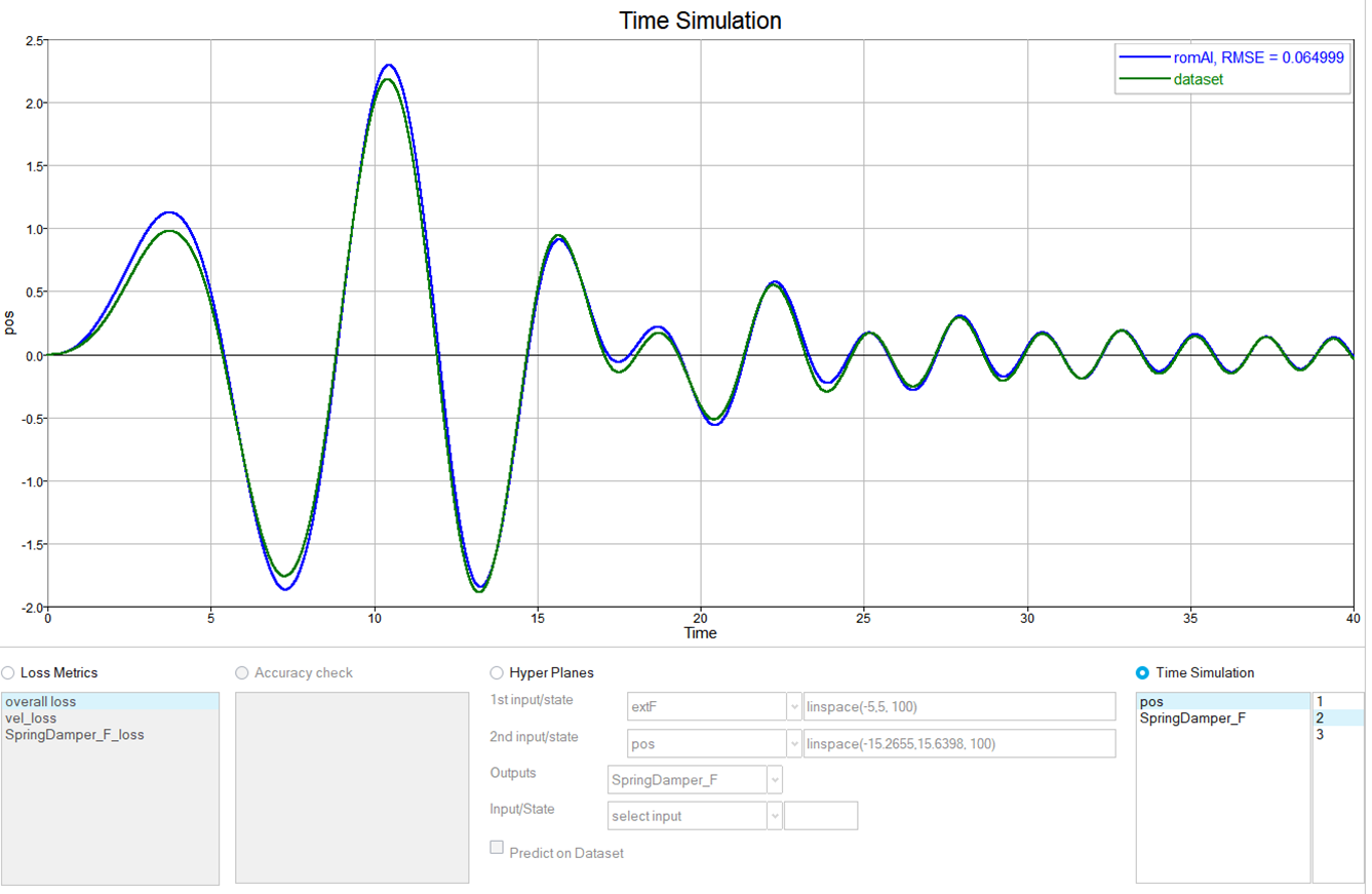

Time Simulation Tab
If romAI is used to generate dynamic ROMs, it is important to have a tool that easily performs preliminary time simulations to assess the accuracy of the transient behavior after the romAI model has been trained.
The Time Simulation tab has been designed to perform these time simulations in just one step.
Use the Import icon to select a dataset file, if not already selected. The selected dataset file name can be seen in the file name info section at the bottom of the dialog box.
Note: The format and labels in the dataset file are the same as those in the training file.
A time simulation is triggered. After the simulation runs successfully, the plot is updated.
The following are drawn in the plot:
  • Blue line: The dynamical results produced by the romAI model, given the inputs and the initial state conditions that are contained in the dataset file.
  • Green line: The target time history.
  • RMSE Metric: Root Mean Square Error calculated between the two signals is shown in the legend.
    Note: The RMSE is calculated for the segment and output currently active.
Use the list box to select the output of the romAI model that you want to plot.
If the loaded dataset file contains multiple time histories, you can select the desired history in the segments list box beside the output list box.
Note: This is a preliminary time simulation. When deploying the romAI model in the Twin Activate environment, more advanced options are available.

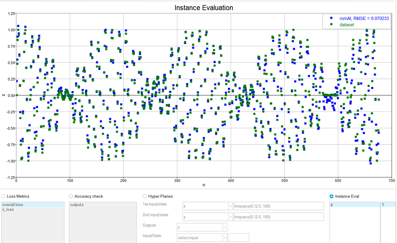

romAI can be used to generate static ROMs.
In this scenario, a time simulation is not meaningful, and it is replaced by a classical inference operation over the loaded dataset. Also, the tab name changes from “Time Sim” to “Instance Eval.”
Repeating the same steps as before, the following scatter plot is generated for a static ROM:
  • Blue dots: The static results produced by the static romAI model, given the inputs contained in the dataset file.
  • Green dots: the target results.
  • RMSE Metric: Root Mean Square Error calculated between the romAI and dataset instances.
    Note: RMSE is calculated for the segment and output currently active.

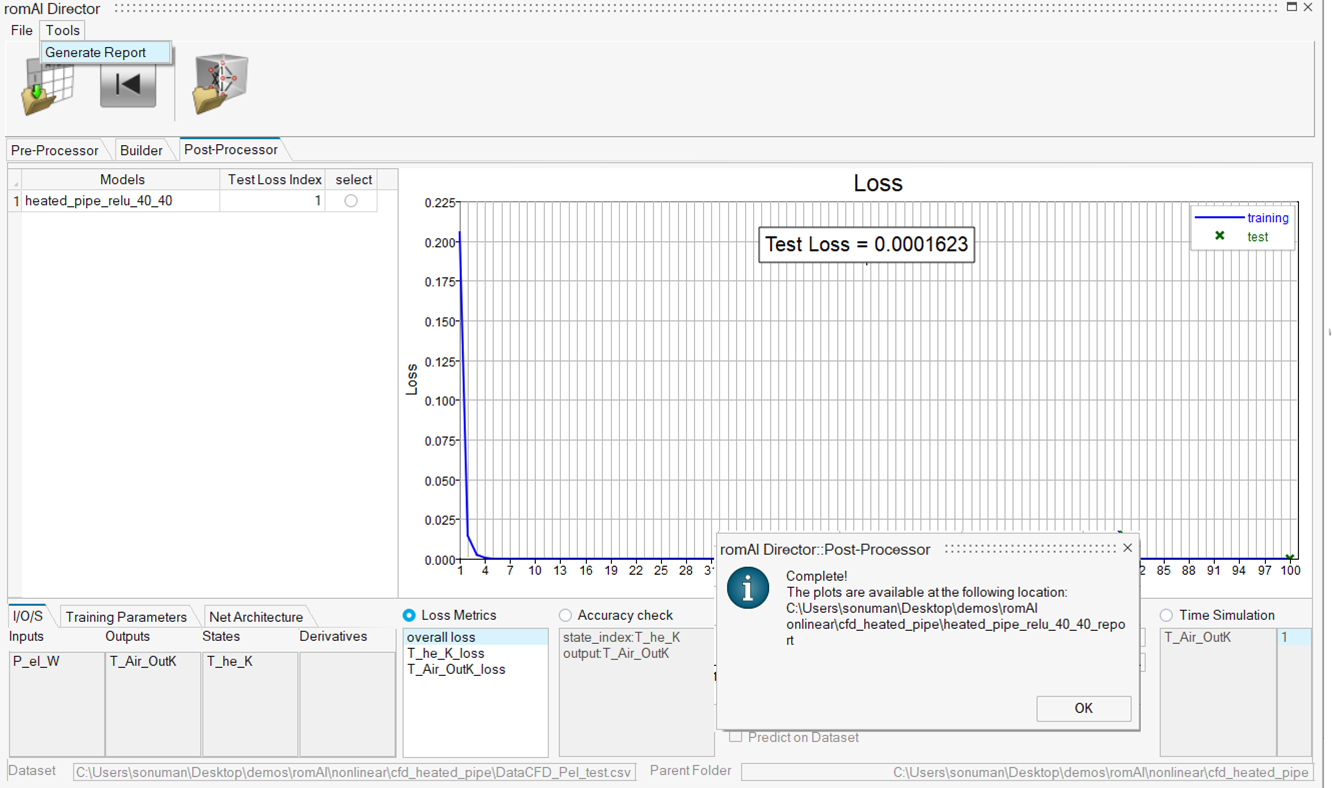

Report Generation
The report generation tools can be accessed from Tools menu.
This option allows the user to automatically test and save the snapshots of following:
  • Loss Metrics
  • Accuracy Checks
  • Time Simulation or Instance Evaluation
The report is saved in a folder with following syntax: <model_name>_report. Also, the folder location is displayed at the end of report generation.

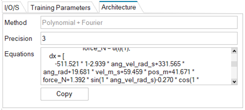

Architecture (SINDy)
When you use the SINDy method, the Architecture tab contains the approximate system equation.
Note: This section is only applicable if Method has been set to SINDy as the training method in the Builder tab.
When you have created a model using the SINDy method, you automatically get access to the approximate system equation. You can copy the formula and reuse it from the Architecture tab.
Depending on the precision set, the coefficient is updated with the corresponding digits.
This feature is useful for creating smarter and more robust control system algorithms.
