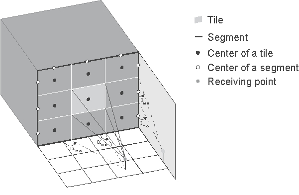

In a first step, the walls of the buildings will be divided into tiles and the edges into horizontal and vertical segments, see Figure 2. After this discretization of the database the visibility relationships of the different elements are determined and stored in a file. For this process all elements are represented by their centers. This leads to a simplification of the problem of ray path finding (possible interaction points are only the centers of the tiles and segments). The visibility relations between each tile (segment) and all other tiles (segments) are computed in the pre-processing, because they are independent of the transmitter and receiver locations.
For the decision about the visibility relation, the line of sight criterion between the centers of the tiles (or segments) is evaluated. If there is line of sight between the centers, the rays from the center of the first tile to the corners of the second tile are determined and the projection of the angles of the rays on the first and second tile are stored together with the visibility relation. A similar computation for the visibility relations between tiles and segments and between segments and other segments is done and also stored in the file of the pre-processing.
The angles of the projection are important, because they define a range of possible reflection (or diffraction) angles for the illuminated tile (or segment). The angle also continues on the neighboring tile, so a very accurate prediction of the rays is possible even if the tiles or segments are large (up to 50 or 100 meters for urban data bases). A further improvement is possible if the grid of the prediction points is also used in the pre-processing, because the prediction plane can be subdivided into tiles and the visibility relations between the tiles of the prediction grid and the tiles (and segments) of the walls represent the last part of the ray in the direction to the receiver.
If the receiver visibility relations are determined in the pre-processing, the only remaining visibility relations to be computed in the prediction are the ones from the transmitter to the tiles (of walls and prediction grid) and segments.
An example for the visibility relations between a tile and a receiving point is shown in Figure 2. For the calculation of the angles the connecting straight lines between the receiving point and the four edges of the tile are considered.
By projecting these four lines into the xy-plane and additionally into a plane perpendicular with respect to the inspected wall, four angles are determined which give an adequate description of this visibility relation.

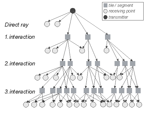

The result of the pre-processing of the building data base is a tree structure containing tiles, segments and receiving points of the prediction area, see Figure 3. In this tree every branch symbolizes a visibility relationship between two elements. For the prediction only the tiles, segments and receiving points, which are visible from the base station have to be determined. Additionally, the angles of incidence for the visible tiles and segments have to be calculated. The relations in the first layer of the tree must be computed in the prediction, all other relations are determined in the pre-processing and can be read from a file.
The ray search is stopped, if a receiving point or a given maximum number of interactions is reached. Finally the field strength is summed up at all potential receiving points.

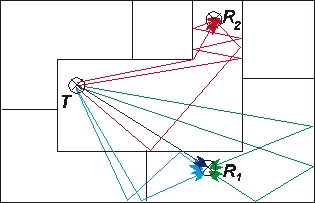

Diffuse scattering in indoor scenarios can play an important role, especially for determining the actual temporal and angular dispersion of the radio channel. The IRT model for indoor scenarios have been extended to consider the scattering on building walls and other objects. For this purpose the scattering can be activated in the model settings (where also the number of reflections and diffractions are defined). As the scattering increases the overall number of rays significantly, there is a limitation of one scattering per ray.
Figure 5. Diffuse scattering.
Furthermore the surface roughness of the corresponding materials need to be defined (in WallMan and ProMan). The scattered power depends on surface roughness and on direction, in accordance with 12. For the scattering in the IRT model the tiles as defined in the WallMan pre-processing are considered. The scattered contribution is weighted with the size of the scattering area (tile). Accordingly the resulting scattered power from the whole object is for large distances independent of the tile size. For small distances there is an impact due to the modified scattering angles which depend on the tile size
