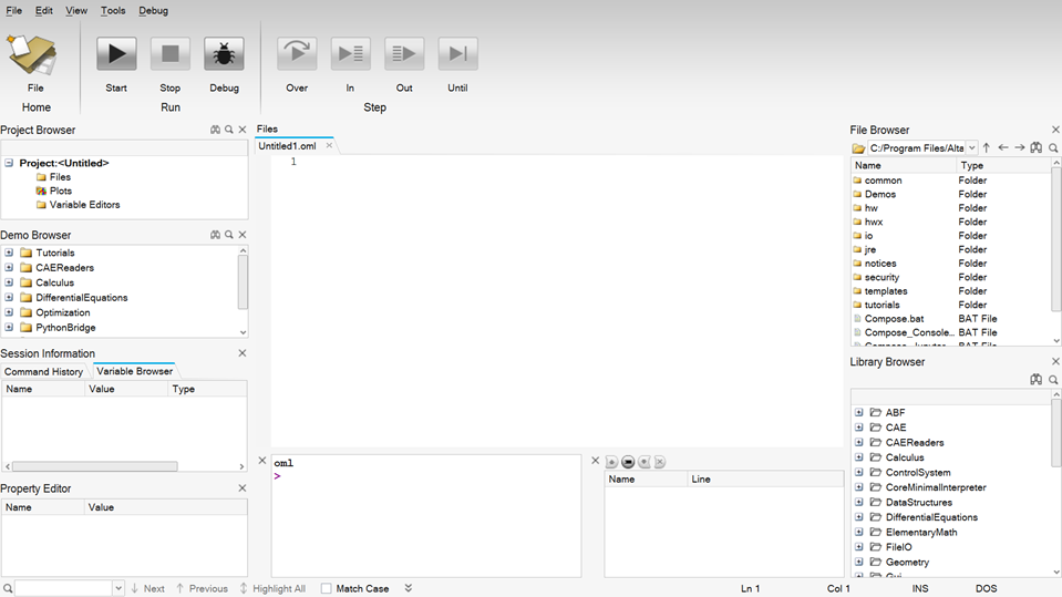

Launch Compose
From the Start menu, click All Programs > Altair 2025.1 > Compose 2025.1.
This launches Compose. Notice that by default, a file named Untitled1.oml exists in the Editor window.
By default, the application is in Authoring Mode, where scripts can be edited and executed interactively.

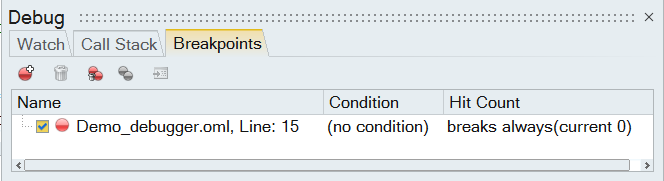

  2. Click the Breakpoints tab, located next to the Call Stack tab at the bottom of the GUI. Or, from the Debug menu, select Windows > Breakpoints.
    A breakpoint is now listed and located at line 15.

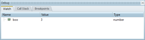

  1. Variables can also be inspected using the Watch window. The Watch window is located in the lower left corner of the Compose GUI. In the Editor window, using the left mouse button, highlight the variable boo, then drag the variable from the Editor window into the Watch window.
    You can also highlight boo, then right-click to choose Add Selection to Watch.
    The value of boo is currently 3.

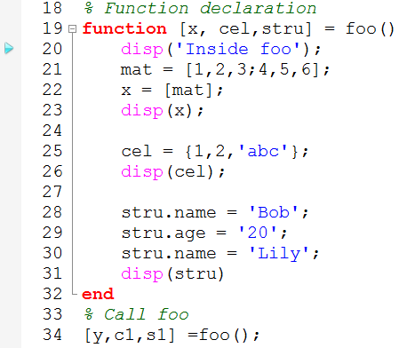

  1. To enter the function foo, click the Step Into icon, .
    Selecting Step Over executes the function foo. If you want to individually execute each line inside the function foo, select Step Into instead.
    Once Step Into has been selected, the blue triangle moves to line 20.

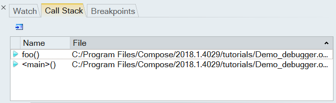

  2. Click the Call Stack window tab. Investigate the contents inside the Call Stack window. The current execution point (line 20) is listed as well as the calling point to the function foo (line 34).

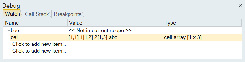

  4. Under the Name column in the Watch window, type the variable name cel.
    The contents of the variable cel are updated in the Watch window. The Type column indicates that the variable cel is a cell and there are three elements in the cell. The values are listed in the Value column. You can also type cel in the OML Command Window to check the elements’ values:

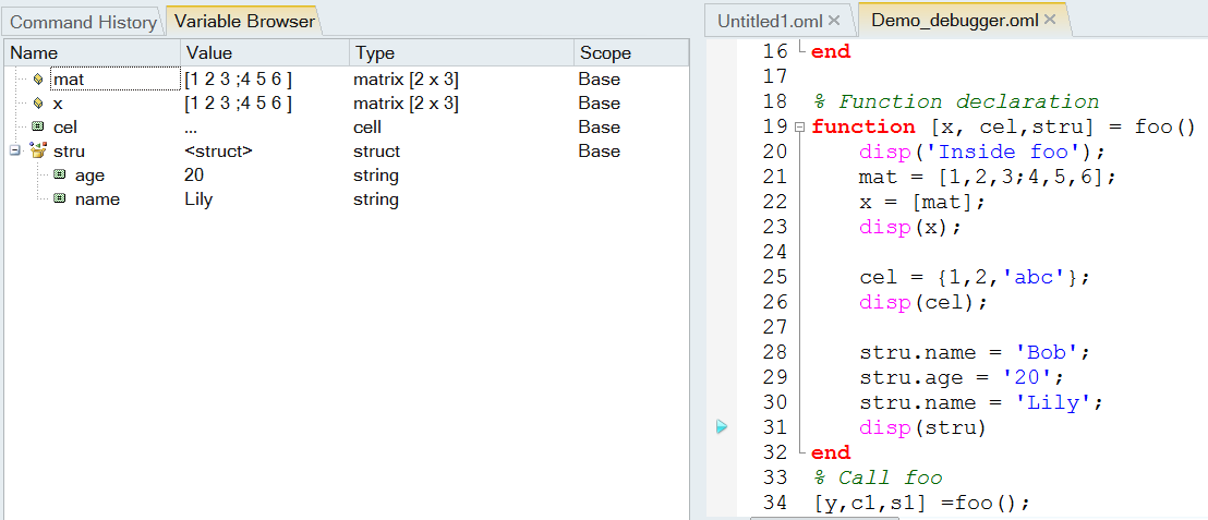

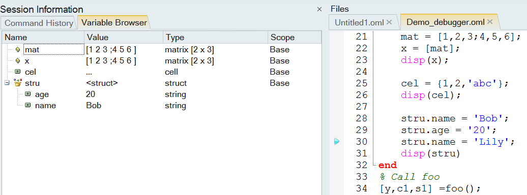

  6. In the script, line 30 resets the stru’s name from ‘Bob’ to ‘Lily’. As a result, the struct’s name field is updated accordingly.
  7. After running line 29, you can view the stru fields by clicking the '+' in front of this struct in Variable Browser. The struct is now expanded and you can see its content.
  8. Check the name field again after clicking :

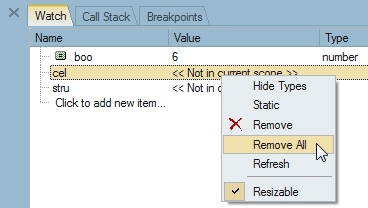

  3. Click the Watch window tab to activate it.
  4. Right-click in the Watch window and select Remove All. Select Yes to the message that prompts if you want to delete all entries.
    This clears the Watch window to allow for a clean look at the variables to be inspected.

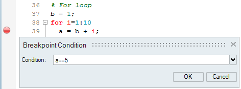

  1. Left-click on the left margin at line 39 to add a breakpoint. Right-click on the breakpoint to select Condition.
    This opens a dialog box for specifying the break condition.
  2. Type a == 5 and click OK.
  3. Click the Run File icon, , to continue until the execution stops at the breakpoint, which is only when the above condition is met as seen from the Watch window.

  5. Click Step Into, , to enter the function foo and move the execution point to the first line in the function. This moves the marker for the next execution point to line 20. Observe the Call Stack window. This displays the execution path through all functions to the current marker location. At the top, it shows the inner most function the execution is currently in (function foo), followed by the next outer function, zoo, which is followed by the main function level.
    Also note the blue marker in the editor margins at locations where each of these functions were called. These lines are also displayed in the Call Stack window’s second column. This allows you to find which instance of a function call lead to the current location, if there are multiple instances.
